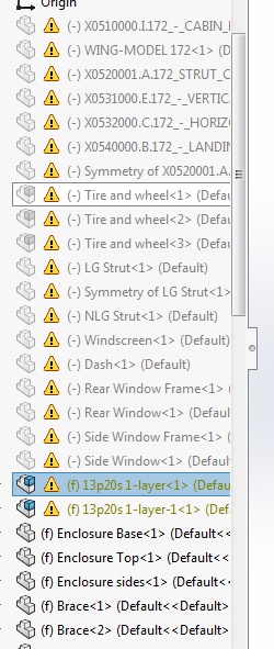

Importing assembly has extra parts that are suppressed when I open the parasolid file.
I went to convert a file that should be a small box and it includes several parts that definitely do not belong in the assembly and they are all suppressed with a missing link to the files for the suppressed parts. I would like to know why these parts are being put into each parasolid file I try to open, and how to stop that from happening.

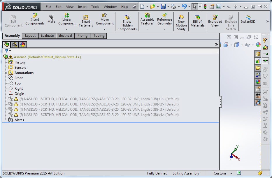

I have similar issue - whenever I export any assembly to Parasolid or STEP, then open the exported file back into Solidworks, there are several files listed that are suppressed links to missing files.  I don't have these files anywhere, and they weren't in the original assembly.  My assembly template is empty.  I can delete the files, save as an assembly, open that assembly, export the parasolid again, and the broken file links re-appear when I open the parasolid.

DG 2016-06-23
Check which assy template is specified in this location. Check and make sure that template is empty/correct.

that was it - the junk was in the template. Thanks!
