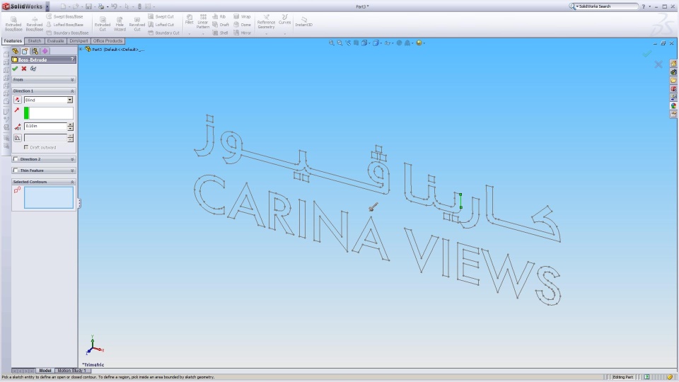

Hi guys,
Is there anyone there who can help me find a solution on this problem..
for you to have an idea, because solidworks can't recognize arabic text in the sketch area
when importing it from illustrator, i need to outline those letters before importing it as part sketch..
but when its imported in solidworks, im having problem on extruding it because of many contour points that makes the curves of the letters,
is there any way that can make the arabic text or any word that converts it to a single entity or block maybe to make the letter extrusion easy.
SolidworksImport export

Hi Joef,
In Illustrator, you can choose to "Create Outlines" of your text - Menu/Type/Create Outlines. Do this and save your AI file then open in SW.
regards
Mark

Hi Mohammed,
The default behavior when extruding (MS windows) text from SW is that it should take all closed profiles and also recognized "nested Profiles" - i.e. the inner part of an "o" for example. For parts of arabic text that I'm not too familiar with, you can then use contour select to manually pick up those profiles.

MM 2012-03-08
Yes, there is. use al-waseet. it is encoding software for arabic fonts. type your text there and past it inside the text tool when you are in sketch mode.
