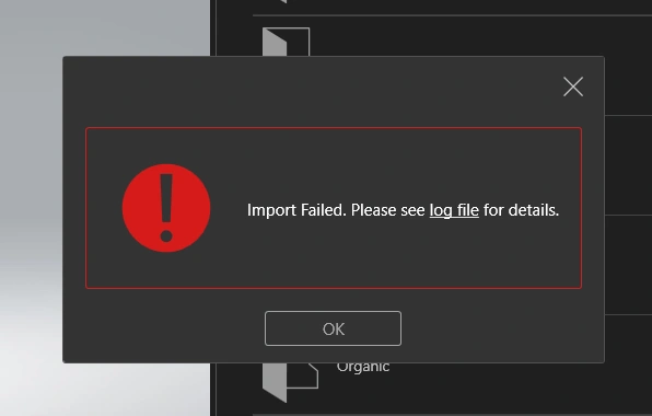

I've been trying to render an animation of a few motion studies of assemblies.  The first one worked absolutely fine, but the second assembly keeps failing when I try to import into Visualize (with the Export Advanced command from the Visualize plugin menu).
The error looks like this:
The log file that the message refers to includes these messages (I've picked out the ones that seem most pertinent but can share the full log if that's helpful):

15625   INFO  Main Application              Notifications.Notifications: Import Failed. Please see {0} for details. log file OK Bunkspeed.Common.Interfaces.UI.NotificationTypeBase
The issue seems to be related to the Wood texture applied to the three parts in the assembly.  If I remove the appearance from all the parts, then I can import into Visualize without any issue.  As soon as I apply a Wood texture to any of the parts then I get the error above.
