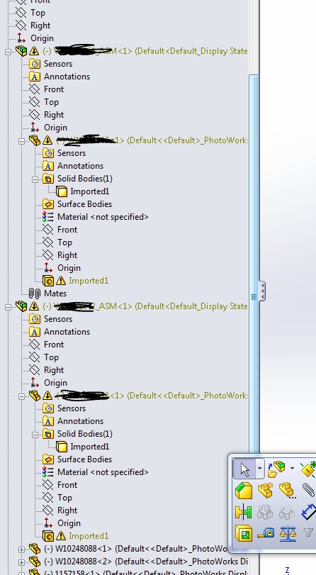

Here is a shot of my feature tree for an STEP Assembly that i mported this morning. i can not run Import Diag's as all the advice online point to it, it is greyed out in my command search and does not appear with a right click on the erroed component. Any ideas on how to fix these issues?
Thanks,
Cliff

I've never opened a step assembly, but I'll take a shot at this.  Looks like you have component bodies you can open up.  Can you open the individual bodies of the assembly, and run import diagnostics on each individual file?

I had the same type of problem before.
The original step file might have geometry issues
I openend each part file with errors and fixed one by one
You can open each part file, do an import diagnosis and fix
It's time consuming work, I don't think there is an easy fix.

Mark/John,
    Thanks! I was able to open the parts indiviually and run import Diag's. That method just did not occor to me.
