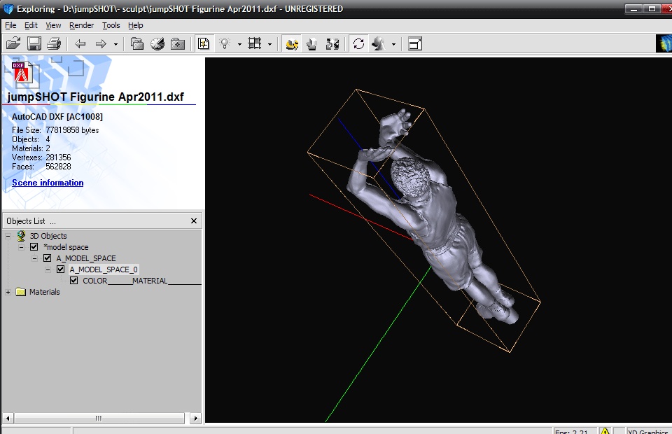

Hi,
I had a sculptor create a 3D figurine in SoftImage.  His OBJ or STL files, as well as their translations to DXF, DWG, 3DM and 3DS formats, show as 3D in ZBrush, DeepExploration and other free viewers (see picture), but all with this result:
A potential plastics manufacturer is telling me that he has "the latest version of SolidWorks. The attachment you gave me is... not a 3D part with mass and a center of gravity. It is only a bunch of vectors outlining the overall shape of the part. ... It looks good, but it is worthless to me and to the injection molding factory. It has no mass or any other kind of detail. You can see it, but the software won't recognize this image is even there."
I do not use any CAD/CAM, but to me ANY 3d file is just a collection of polygons, vertices, nurbs or whatever that can be virtually overlayed with a texture or filled with a virtual material - not a solid. So, there should be some way to import/convert a 3D object from "artistic" (SoftImage, Cinema4D...) to "engineering" (SolidWorks, AutoCAD...) software, as even the picture shows, n'est-ce pas?
Can you please tell me what can be done to use that sculpt in SolidWorks? Recreate it in CAD/CAM is not an option for the artist
Thanks,
vm

SF 2011-06-12 Best Answer
V.M.,
Your plastic part manufacturer wants to use SW and he wants a good solid model to start with. You need to look into a number of the threads in this forum. The latest one by Charles Culp is quite likely to be very helpful ("How to import larg STL files (or any mesh)"). This is not going to be a pain-free process.
Another plastic part manufacturer might not be so picky. Most CAM tools don't require that the model be solid. They are quite happy with a collection of surfaces. I'm not familar with the formats that you mention, other than STL, but there may be CAM packages that can import them directly.
STL files are not terribly useful for any other purpose than making rapid prototypes. They break the original model down into a collection of triangular faces. The number of triangles depends on the accuracy that you ask for. If you got a suitably detailed STL file, then you may be able to get a suitably accurate machined mold out of it, but most STL files are too crude for a good mold to be made from them, because the rapid prototyping machines usually can't make detailed enough models to require the level of accuracy needed in a mold.

Thanks for the quick reply, Jerry!
I did read ~8 previous threads, but nothing seemed to help me. You don't seem to give me much hope as far as SolidWorks goes either. Perhaps I should've known after finding that it's a French sw: long time ago in a universe... I consulted to a French airline on their reservation system, and they'd do ANYTHING to NOT be like the american sw.
Two of the formats I gave the manufacturer are AutoCAD native: DXF + DWG, both 3d as the pix shows, detailed enough with 560 000 faces. Is there no way to "stuff it" by assigning a material to the 3d shell in SolidWorks? Is SW that incompatible with the old standards like AutoCAD? Grrrr... and yes, you are right, other manufacturers had no problem using the OBJ or STL.

V.M.,
Unfortunately, SW only imports 2D .dxf and .dwg files, not 3D models. The best way to get the 3D model into SW would be a Parasolid file (*.x_t or *.x_b), STEP file (*.step or *.stp), IGES file (*.igs or *.iges) or ACIS file (*.sat). You could also try bringing it into another CAD modeler and then importing it into SW directly, like Pro/E  or CadKey or UGII (*.prt), Inventor (*.ipt), Solid Edge (*.par), or Rhino (*.3dm).

WF 2011-06-13
I hate to disagree with Jerry, but SW will definitely import 3D ACAD parts.  I'm not saying that it will do a good job of it, but SW definitely imports 3D .dwgs.

VM,
The best bet for this is to use ScanTo3D, which is a SolidWorks Premium product. It allows for the import of mesh data, and aids in the conversion to NURBS surfaces.
There is no "easy" conversion from mesh data to NURBS data. In fact, T-Splines, a SolidWorks partner, has just introduced a product called tsElements to help bridge that gap. It can actually open native OBJ files into SolidWorks. Now, these OBJ files cannot be made from triangle facets, which is what most programs output. It needs to be a much "cleaner" model.
In my previous thread I show a video of how to import mesh models into SolidWorks, but this is merely a "looks good" import. All the faces will be large facets, and not smooth.

I've seen your video - Jerry Steigner pointed me to it. I have a DWG translated from STL + OBJ files (using DeepExploration - see the picture at top ). It has 560K faces, so it may be fine enough.
1. Re my manufacturer's statement above, will the DWG be imported into SW as an empty surface, or as as his 'solid with a center of gravity' etc.? How about tsElements? (sorry, I've just read the answer in your video thread!)
2. In your video, as you move pointer over the imported controller, there are some (brown?) curves flashing on, mapping closely the model. Can those be used to smoothen the model 'in bulk' rather than doing 1 facet at a time?
3. Can SW be used successfuly to make things like a photorealistic statuette (I'd like to get NBA players' licenses for my patented table basketball eventually, see www.jumpshot.co) or is it limited to 'technical' shapes that can be reasonably calculated? As I said, the artists I talked to don't use CAD/CAM...
vlad
btw, what is 'a much cleaner model' compared to polygonal mesh? Splines and nurbs?

Vlad,
SW can be used for shapes like people and terrain, but it isn't a particularly good tool for the job. Kind of like pliers can be used when you don't have the right wrench.

Tell your sculpter that the sculpt is not "watertight" this is a must when doing this. i use z-brush files all the time using the stl importer from sycode and and when they are not watertight the will not open as a solid.
can you post the stl model?

hmm, not tight... that may be the problem, thanks. When he was creating the figurine, I seem to recall 4-5 overlapping meshes. Not sure if he's 'unified' them eventually...
I'll have to check what size files I can post here. The models have ~500K faces: STL = 27MB, and translated DWG = 15MB. Can I upload it to your ftp

Programs like softimage and zbrush are mostly used in the CG world they dont care about closed meshes.
no ftp! sorry, not to mention at 27mb that would get my computer spinning for hours to convert it.
have your artist "decimate" the model (reduce the poly count). i use files in the area of 2mb. It does make the little facets larger doing this, but we use an objet 3d printer and when printed out you cant tell. Once in sw you will need to check the scale of the figure. with all the conversion going on it usually looses the sculpted size.
