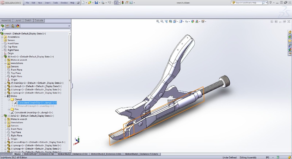

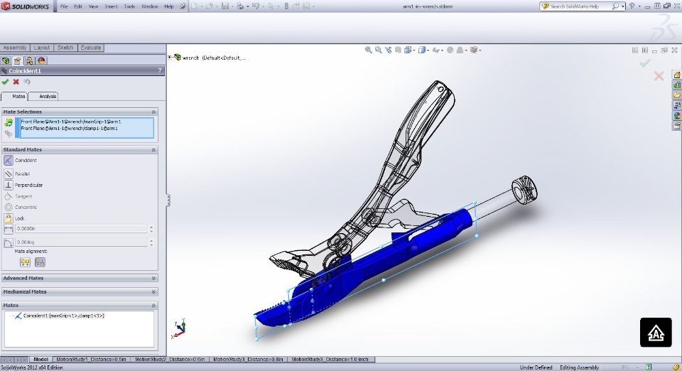

But sometimes, the pComp0(CComPtr) gets the null pointer even its corresponding IMateEntity2 is not null.
So I tried to see the reference manual of IMateEntity2::ReferenceComponent() function. And I could find a description there:
'The component instance tree of a subassembly is not loaded because a subassembly does not have a view of its own. Thus, this property returns NULL if the Inplace mate is in a subassembly. '
But I could not know whether an IMate2 can be an IMateInPlace.
The example assembly that I could see the problem is here:
In the "C:\\Program Files\\SolidWorks Corp\\SolidWorks\\samples\\tutorial\\api" folder, there is 'wrench.sldasm' file.
I attached two capture images of the mate that makes this problem.
