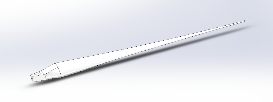

Hi,
I am trying to convert a part to IGES. When I do I get the attached error message stating about the translational error. If I click ok it then creates the file, but with a missing surface(s). Basically I am designing a wind turbine blade and it is to be analysed so for that, I need it in IGES form. But the whole airfoil part seems to be disappearing in the igs format.
Any help would be really appreciated.

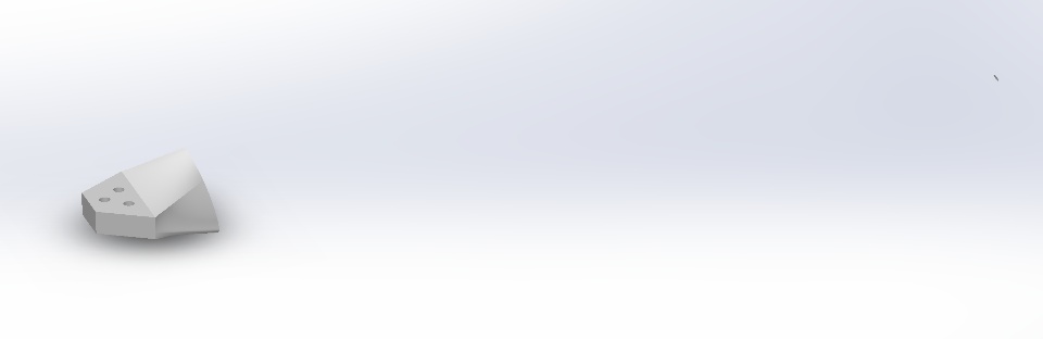

 ,.. see attached.. I cleaned up the wing loft (made sure all knots were aligned... ideally, the trailing edge should not be sharp(ie) and they do not exist in the real world.. so, the sliverish issue comes downstream.. and yes, I'm sure many people get away with this working),.. so, I made a separate transition loft to the mounting loft which I also cut back to help with the blend (your fillet)..
Now, it's fairly clean but the transition loft will not merge or combine with the wing.
..enter,.. Workaround #2 & #3... export as a IGES and open the IGES,. and Combine.. now you can export as a whole IGES.

Hello  ,.. you'll need to clean this up... (image) although it seems to pass analysis and saves as a parasolid without issue (but fails as a iges or step).. if you look at the curvature at a high image quality (~.078), it looks pretty messy... maxing out the image quality to <.077 (full red), the wing tip disappears,.. that is, the mesh fails..  As a work around, if your other software can read other types of data, you could saveas a STL ?

Try converting & unchecking "Split periodic faces".  It converted with NO errors for me, with these settings.  If you leave it ON, it Fails...

Using SW2019sp4, i got a clean conversion by unchecking "Split periodic faces"
