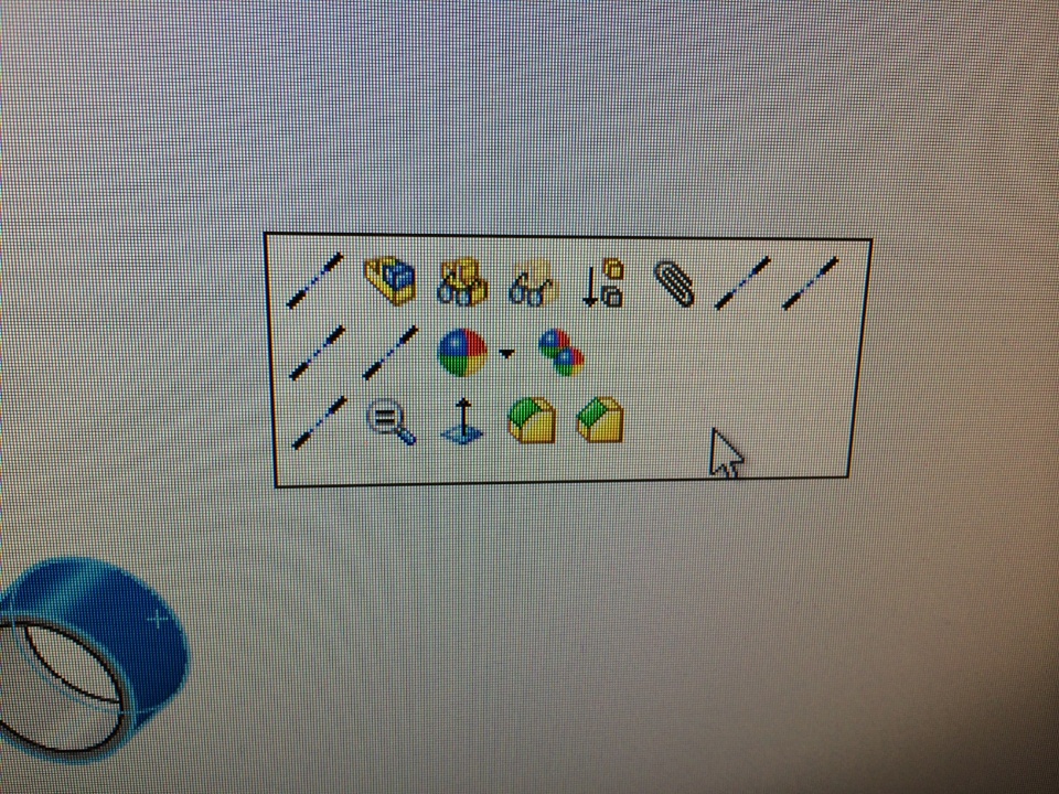

When I select a part, inside an assembly or the part file, my icons appear as per the attach photo.
See attached Photo

Any luck with this issue?  It looks like you are selecting a cylindrical face while in an assembly... is that correct?
We appear to be showing the "Make Collinear" command icon in 6 places on this context toolbar.  If you move your mouse over these icons does it show the correct tooltip for the command which is supposed to be displayed (ie: "Open part", "Edit Feature", "Select Other" for the left-most icons)?

I too am having this same problem. Sometimes it's the colinear icon in several places, sometims it's the perpendicular icon, and most often, there's no icon at all. The missing icons don't seem to follow any pattern, either. The affected icons appear to be random.

The problem of missing icons, icons displaying with an underline or the same icon being shown multiple times on a context sensitive right mouse button popup-up menu is caused by a few inconsistent icons within SolidWorks.  This issue has been tough to reproduce because there are only a few of these invalid icons in existence, and your workflow needs to cause one of these icons to be loaded first in order to see the issue.
This problem has been fixed for SW2014, SP3.0.  In the meantime, to avoid the problem, the following workflow will assure the toolbar and menu icons are correct:
1.  Start SW.
2.  Create or Open an existing part.
3.  Mouse over the "Edit" menu from the main menu bar so the drop down menu appears.  This will cause an icon of the smallest size to be added to the image list first.
For those of you interested in the details… SolidWorks creates an image list to keep track of the icons that the user has accessed.  The first icon that is placed on the image list determines the sizing for each additional icon that is placed on the image list.  If an icon that is slightly larger than the standard 16x16 icon is placed on the list first, the problem occurs.  Since the order in which these icons are placed on the image list depends solely on user workflow, this problem is intermittent and difficult to reproduce.  And since this image list is rebuilt each time SolidWorks is started, simply restarting SolidWorks and doing a slightly different workflow can fix the problem.
