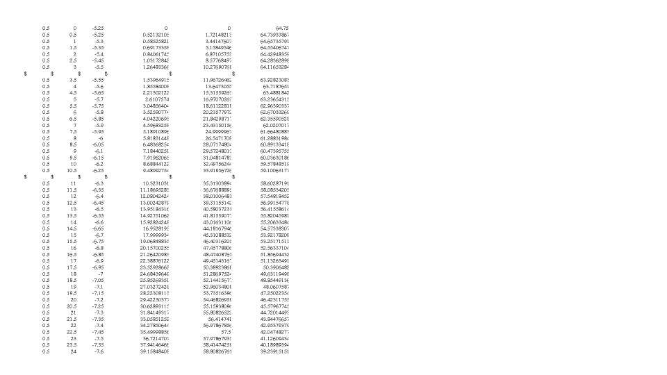

in the attachment there is excel file and macro file.
there is a special symbol "\\\$" in the  excel sheet and i want upto \\\$ sign the curve1 with points in column 1,2,3 and 2nd curve with point in colummn 4,5,6 and after \\\$ sign the curve should generate in curve 3 with points in column 1,2,3 and curve 4 with points in column 4,5,6.
so my question is is this thing possible in macro coding. what will be the modification required.
