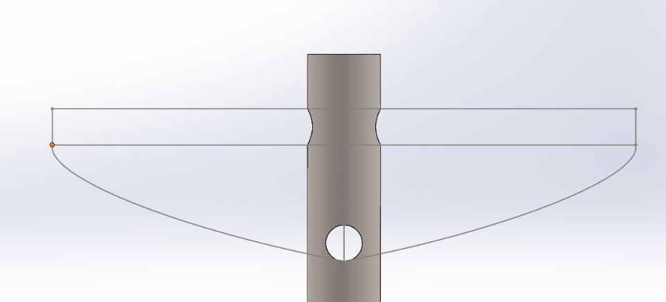

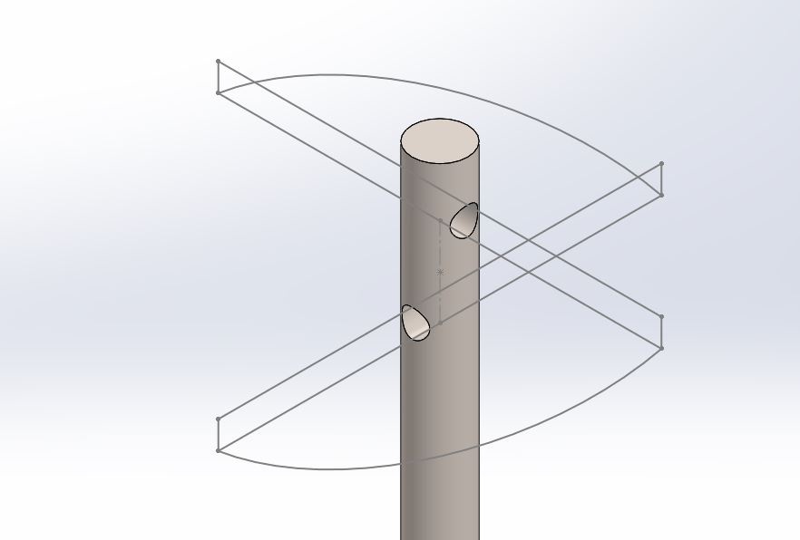

You see the ends of these pieces? I've been trying to create my own, but the loft between them keeps on failing. Need it to be variable, as I want it for a specific application, and using it as more of an internal cam than a locking feature.
Attaching a copy of the part, and my attempted loft. As well as some pictures.

Found a way. Had to pull the sketch of the cut-through to outside the cylinder, and use a curve driven pattern with an extreme amount of instances, but it works.

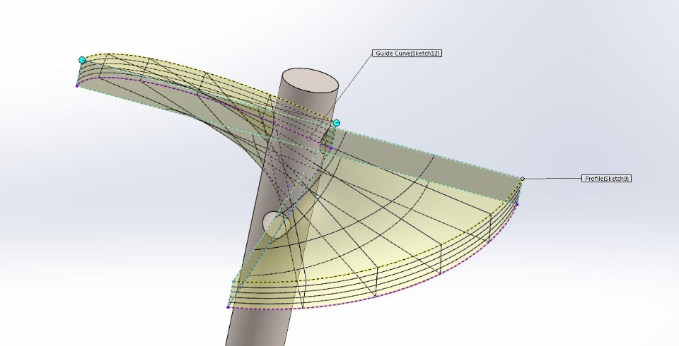

Here is much simpler way, solid sweep cut. Please add dimensions as required.
