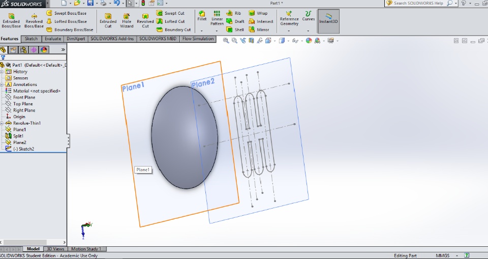

You can simply use the cut extrude and then offset from surface option in that to cut to some depth maintaining the same surface OR even Wrap feature with deboss option.

Does wrap work on doubly-curved surfaces?

Using this technique, you can get a nice result ( ) It's a way to wrap it, because I don't think you can wrap on a surface with complex curvature.

On immediate further consideration, you could skip 3 steps by just lofting a cut from the sketch to the origin.

NO but that was just a suggestion.

You are right: the wrap feature doesnt work with spherical surfaces. Thanks alot for your help.
Try Split-Line.
