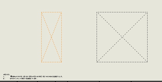

I HAVE LOST THE LINK BETWEEN MY DRAWINGS AND I CANT SEE MY VIEW DRAWING
NORMALLY IT IS POSSIBLE THE CHANGE OF NAME A DRAWING, AND I CAN LINK THE DRAWINGS WITH THE ORIGIN FILE WITH THE WINDOWS HELP FROM SOLIDWORKS... THAT'S THE NORMAL.
BUT NOW, THE WINDOWS HELP FROM SOLIDWORKS DOESN'T APPEAR AND I CANT LINK THE DRAWINGS.
THE DRAWINGS HAS THE SAME NAME AND THEY ARE IN THE SAME FILE.
