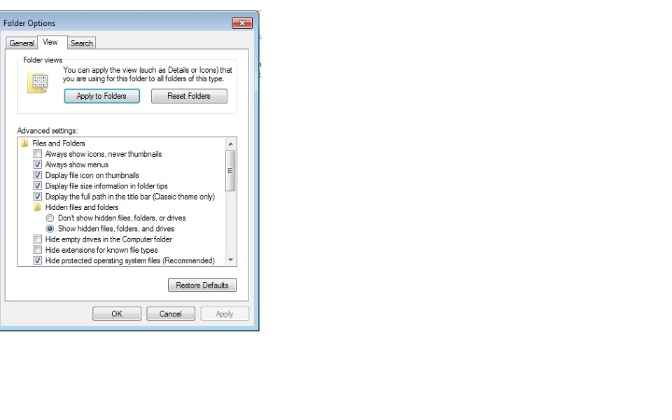

Here is another thumbnail setting for Windows Explorer FYI.

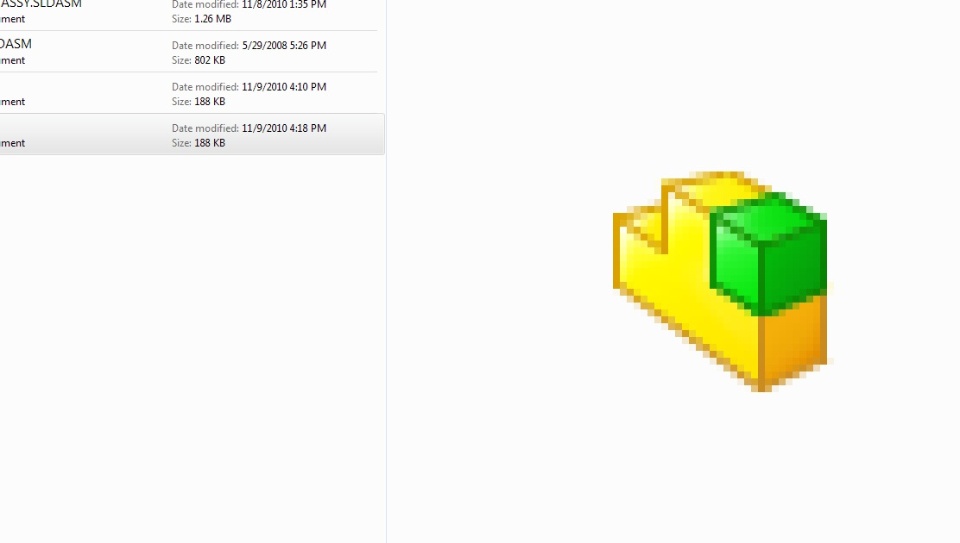

SF
SF 2010-11-10
Thanks Scott,
I did have that option deselected, but after selecting it, it still does not give me a preview.
Please see attached Jpeg.
Thanks,
RG

SF
SF 2010-11-15
Hi All
So here is what solved the problem.
I got IT involved and it turned out we did not have to reinstall the software.
The problem was on the Windows explorer setting.
So.... to fix this problem you would go to Windows Explorer window,  Tools, Folder Options, Under the View tab, make sure the ALWAYS SHOW ICONS, NEVER THUMBNAILS is DESELECTED.
This will take care of this problem.
Thanks again for your help.
RG
