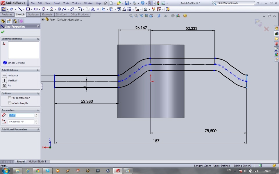

I cant create barrel cam
I tried to create the barrel cam but it didn't work. Can somebody tell me how exactly to create it. I read a lot of other posts but I dont get it. Here is what I did.
On the first pic is what i have to do , but obviously something is wrong. Can somebody help me.. please

What is the cylinder's diameter?
Just curious, why do you use such crazy splines for the transition?
SF
SF 2012-03-25
diameter is 55mm . About the splines -->  i dont know how to make it so i try diffrent ways. I was thinking to do it somehow with helix/spiral but I couldnt .

Can you open SW 2012 files?
SF
SF 2012-03-25
no I was with SW 2012 but it is kind of slow of my laptop..   but if you have the answer on 2012 I will try somehow to install it again.
AV
AV 2012-03-25
This is the file in SW2012. If you need a video on how to make it, let me know.

wow, nice, if can post me a video will be good, so I can do it while looking at the video Thanks in advanced

You can watch the video by clicking on this image:

Thank you soo much. I really appreciate your quick answers and support. Now I know what was my mistakes. Thank you again

Thanx Mr.Alin,
     Can U explain how to mate this cam to follower?.....
