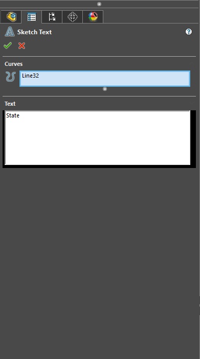

I have been using sketch text on a part and was editing the text just fine. I am unsure what happened by now I can only select curve and write text. All editing options are gone. Is there a way to restore this?
Hi Brad,
I would say this seems like registry corruption as there is no way to remove that formatting area.
Try closing SolidWorks, opening the Rx tool from your start menu, then at the bottom of the home page click the link for launch here bypassing tools / options and see if your tools show back up. If they do then you could try resetting your registry.
Close SolidWorks and the Rx tool
Open regedit, navigate to HKEY_CURRENT_USER\Software\Solidworks\Solidworks 20XX and right click the Solidworks 20XX folder and rename it to something like Solidworks 20XX backup.
Launch SolidWorks and test.
