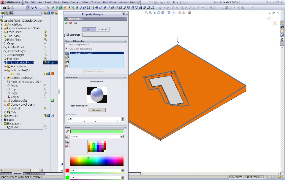

I can select the face but cannot color it
The upper surface of my clay body is bounded by a surface-loft, which is hidden because it is inexplicably tesselated.
An excavation is cut-extruded into the clay.
An LC on the remaining upper surface of the clay body, selects in blue the "donut" that I want colored green, leaving the cut faces in orange.
So far so good.
When the Selected Geometry is applied at Component level, all faces of the clay body turn green.
When the Selected Geometry is applied at the Part level, nothing turns green.
How can I get just the selected area to turn green?

Thanks guys;  I have a better understanding now, but the problem persists.
I can't follow this instruction "go to the appearances tab, right-click on the green color and do 'edit appearance' it will show you which enttiies have the appearance mapped to them."
I went back to the land part and found that although the clay body was colored orange, more than one face had a green color when I wanted only the upper face green.  I corrected that, and hid the surface loft, and made the clay transparent in order to show buried bodies.
Here is the land part edited in the context of the assembly.  The colors are correct.  The top of the slab is poking out of the ground.
When I close the edit, the green color in the part is not propagated to the assembly.
I tried re-applying the green to the face at part level but nothing happened.

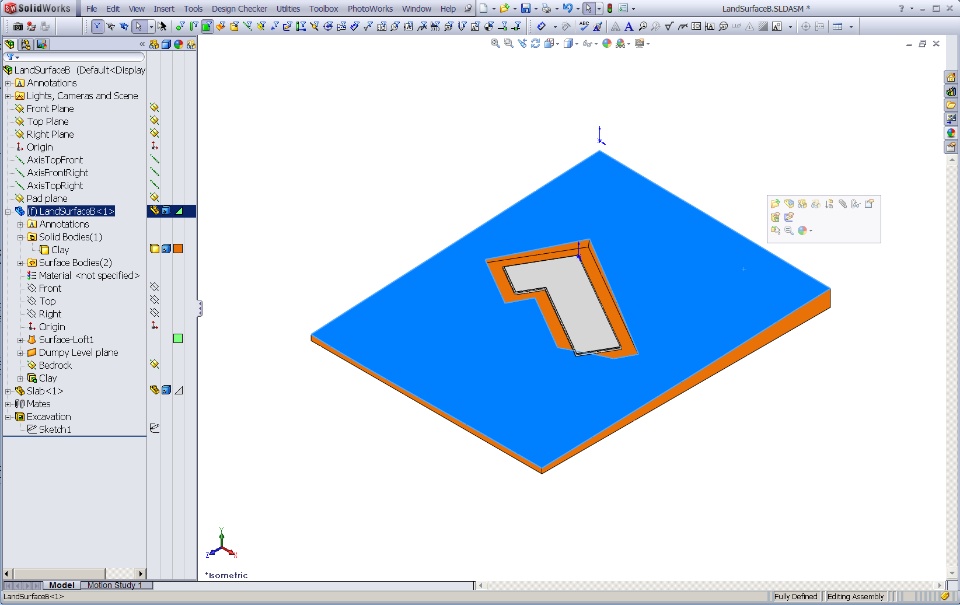

In the example below I colored the solid clay body orange, and the (extrude) feature which defined the body green.
The excavation (cut-extrude) cut the feature surface and exposed the underlying body color.
There are other permutations which achieve the same result.
comment imagecomment image

You hexed me Jerry!
The last image was posted before shutting down last night.  This one is how the document appears this morning, although the preview image was as I saw it last night.
The clay feature color is being ignored, just as my attempts to color a face were ignored.
Restarting SW, restarting Windows, and powering down, made no difference.
Even the backup copy is now ignoring the clay feature color.
I have printed the 2 uploaded images and compared them side by side.  The only difference is that the clay feature color is ignored in the second image.
A Photoworks render displayed the correct colors.
Exiting large Assembly mode to enable Realview made no difference.
Switching display style made no difference.
A Section view displayed the correct colors.
Switching back to regular views lost the color.
Here is a SW view + Photoworks view.
comment imagecomment imagecomment imagecomment image
