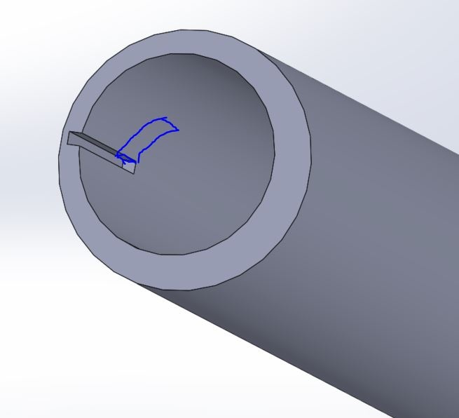

I am trying to cut a groove inside of a cylinder that will be used as a quarter turn to connect two components. How can I go about this?
I am trying to connect some 3d printed components without the use of glue, adhesive, or snap fit joints. I want to use a quarter turn that will lock the two pieces together. I have a cylinder and am trying to create a cut out path on the inside of the cylinder to have a path for the other joint to connect to.  I am attaching an image of the cylinder. I want to create a cut where the blue marking shows. How do I go about this? I tried using the revolved cut but am unable to select an access of rotation to cut around.

Hi
Here's one option,
Create a sketch on the end of the tube that has the outer radius the same as what your keyway outer radius is and an inner radius slightly smaller than the inner diameter of the tube. Ensure that your sketch goes past the point of 90 degress by half the width of the keyway.
Now do a cut extrude but with offset settings. The offset will be the depth of your existing keyway and your cut extrude depth will be pointing towards you. Ignore my diamensions in the graphics area as this was just a quick mock-up to help you.
Now you have your quarter turn locking keyway..............
Dave.

<p>Isaiah Engle wrote:</p><p></p><p>I am trying to connect some 3d printed components without the use of glue, adhesive, or snap fit joints. I want to use a quarter turn that will lock the two pieces together. I have a cylinder and am trying to create a cut out path on the inside of the cylinder to have a path for the other joint to connect to. I am attaching an image of the cylinder. I want to create a cut where the blue marking shows. How do I go about this?<strong style="text-decoration: underline;"> I tried using the revolved cut but am unable to select an access of rotation to cut around</strong>. </p>
You can place a construction line in the sketch used for the revolved cut, and use that for the axis of rotation.

do  as Dave suggested and use the offset from surface.  or make a plane and sketch on it.  then make the cut.

If you make the profile sketch on a plane that intersects the temporary axis of the cylinder, you should be able to select the temporary axis as the axis of rotation.  Make sure you have the axis visible when you start the Revolve Cut feature.

Hello Isaiah,.. fyi, it's a bayonet mount, coupler, connector  (bnc)... some reference info below,..  otherwise... you could start a sketch at the bottom of the existing slot and cut upwards?
