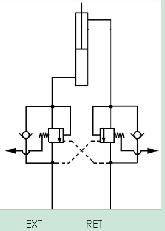

Where I work we manufacture hydraulic cylinders.  On our top level assembly drawings we
always show the schematic for it.  I have been told there are websites out there that have
downloadable generic standard schematics that can be used to insert into SW drawings.
Does anyone know of any good sites?
They look something like this.

We use Microsoft Visio for any air or hydraulic schematics we need to do. It has most all of the flow symbols you would need. You can then imbed the file in the Solidworks drawing file & it works like any OLE object.

Scott you can also create a library of blocks, Which is what i did at my last company. then you can just drag the blocks in and add skecth relationships to form the P&ID. the advantage of blocks is the are native to SW and you can scale them

import an autocad P&ID key dxf file if you can find  one and  turn the sketches into blocks

P&ID   are generic in terms of dimensions and styles to the plant designer, you can search google and see if any thing pops up. I would start by researching and drawing up the common symbols you need and  build up the library as you go along as that what i did at my last company.   There is an iso document on P&ID symbols as well which you should ought to get the company to buy. The one i built up and used was done in solidedge and i don't have a copy of it.
I would also suggest to create a draft document containing the symbols and  a descriptions I would also configure the blocks to show to show closed and open valves/ and instrumentation to have instrument abreviation and number. it save a lot of ballache an libablity if you do this. Drain valve are suppose to be left in the closed position except when draing the system for example.
