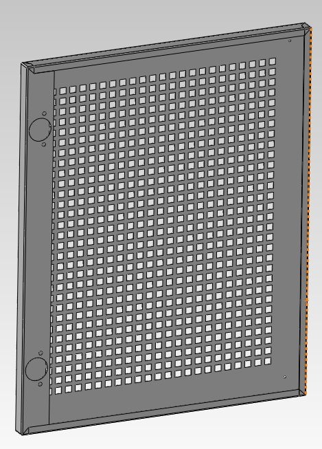

This is a sheet metal part; a ventilated cabinet door. Its dimensions and the resulting pattern are controlled by a design table... there are only two configurations - default and flat pattern.
Despite numerous attempts at "save as..." its file size stays at over 40 MB and it takes over 7 minutes to save if changes have been made.
This is driving me bananas, as there are three such files in my assembly now (with slightly different sizes) that occasionally get changed by a millimeter or two.
Besides suppressing the pattern - as I would have to keep unsuppressing it anyhow to get the proper flat pattern, etc. - how can I get the file size down and keep it down?

I would make another configuration with the hole pattern suppressed. Use that configuration everywhere you can get away with it. Be sure that any changes are made to all of the configurations.

Change you design tablefor the hole cutouts to be patterend under the cut instread of doing a linear pattern.
