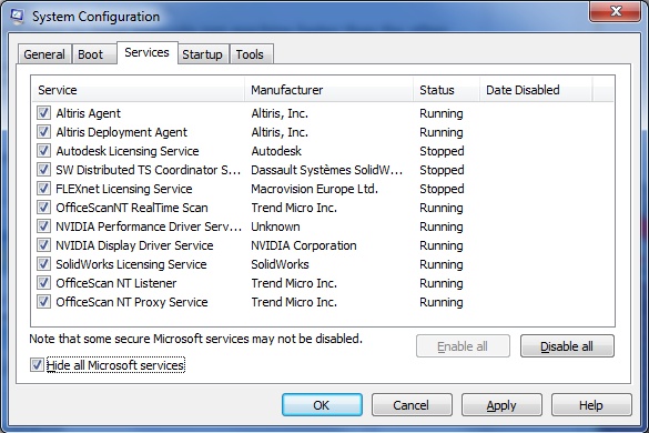

SF
SF 2010-07-15
Win7 also enables you to see what services are running and allows you to turn them off temporarily. There could be something running that is eating up RAM and/or cpu. Once you identify that is the problem you can either turn the services off or uninstall them.
read the following before actually doing it, making sure you understand what you are doing 1st
  1. Click Start , type MSCONFIG in the Search box, and then press ENTER.
  2. On the General tab of the System Configuration  window, select Selective Startup.
  3. Under Selective Startup, clear the Load  Startup Items check box.
  4. Click the Services tab, select the Hide All  Microsoft Services check box, and then click Disable  All.
  5. Click OK, and then click Restart.
    Note: You may experience a temporary loss of some services functionality when  you follow these steps. Restoring the settings restores the  functionality.
  6. On Restart, click Start , type %temp% in the Search box, and then press ENTER.
  7. On the Organize menu, click Select All.
  8. On the Organize menu, click Delete.
  9. Click Yes.
open SW2010 and run the benchmark, if you see improvement it is because there were services running that were eating up CPU &/or RAM
to return system to "normal" (what it was before):
  2. Under the General tab, select Normal Startup.
  3. Click OK, and then click Restart.
  4. identify which services are not neccessary and uninstall/turn them off, you can do this by comparing to your other machine (in fact do this by going through step 4 on both machines (then cancelling on the "good" machine). you may not need to dgo through this process if there is something obvious that you know is eating up CPU/RAM)
SH
SH 2010-07-15
Hi Mark,
After following your very well-articulated procedure (thx for that), SW (2009 sp2.1 x64) failed to load.  The SW splash screen came up, but the application didn't launch.  I've included a screen grab of all of the non-windows startup items for info.  Any ideas??
CC
CC 2010-07-15
if it shows the startup screen, and then just appears to do nothing (no notice of crash,etc), then check and make sure there is no SLDWORKS.EXE running in the processes tab. If it is (and by now there might be multiple) kill it (them). Then just try again.
*Edit:
Also, if you disabled "SolidWorks Licensing Service", it will also not work. So if you followed Mark's suggestions from above, make sure that is running.
SH
SH 2010-07-15
Charles,
Ya, I disabled licensing service inadvertently.
After re-enabling licensing service, it benchmarked a considerable 252s.  If nothing else, its consistent!
Shaun
