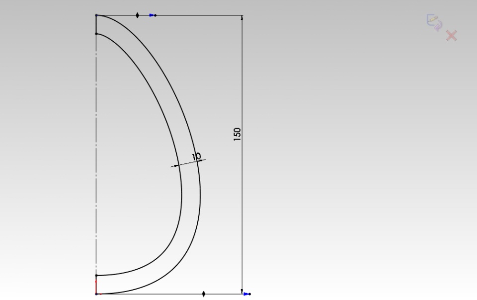

2: This shows the start of the design process.

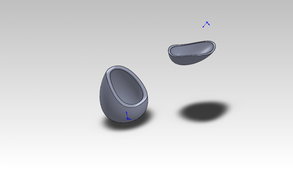

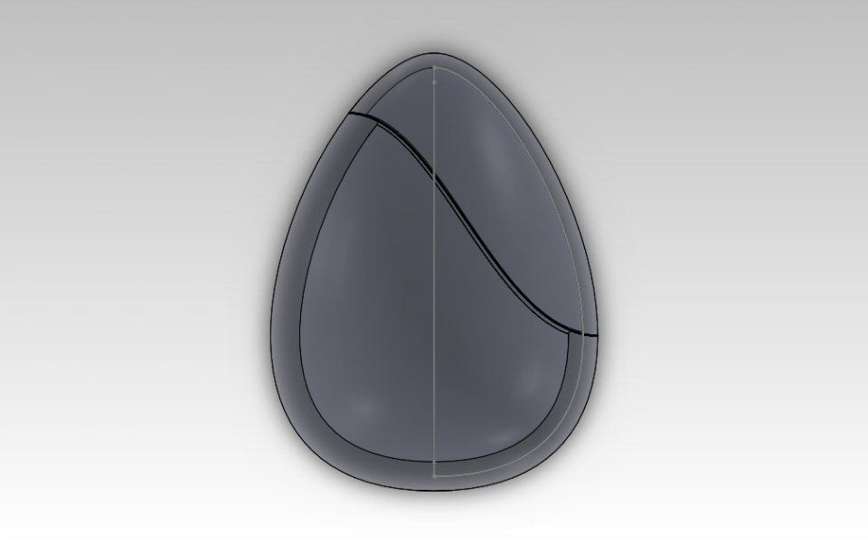

3: This is the spitting step using a simple surface.

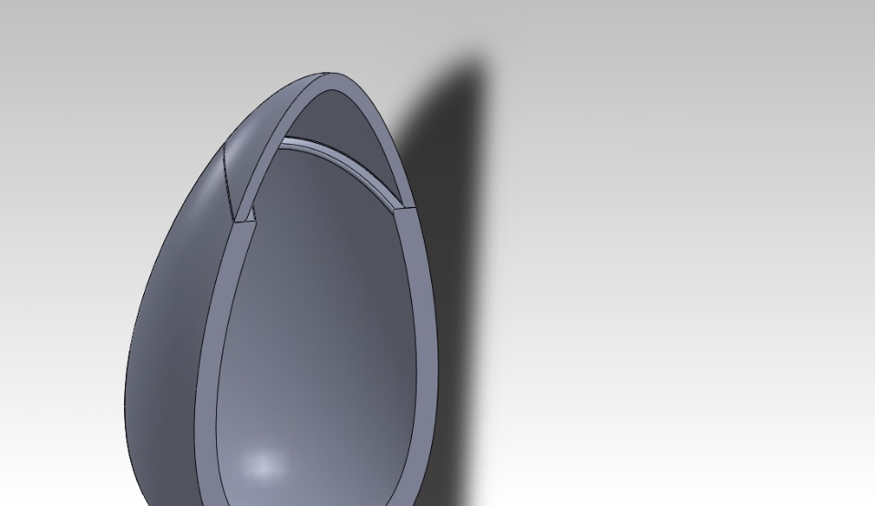

4: I wand to add another eventual "mate" difficulty by having the cap slightly thinner.
5: The basic part is complete... now we save both bodies in seperated part files.
6: In a new assembly, we add the two parts (i.e. Cap and bowl) and our challenge is to mate/position them together. (HOW ?)
