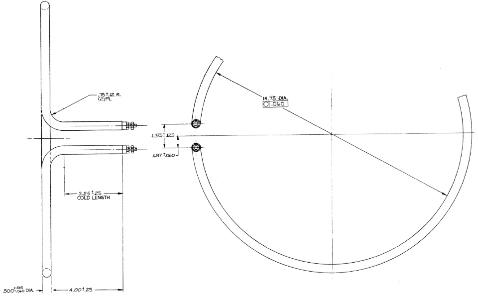

how would you make this model
Can anyone tell me how I should go about making this part in solidworks?  PLease see the picture below.
Thanks in advance for any/all of your help.
Chris

Sweep along a 3D sketch path.

here is my attemp - this may not be the best way to generate the path, but this is definately a sweep part.

I was looking at your sketch and I know how you made the radius tanget to the vertical lines.  What i can figure out is how you made the radius follow the same path as the circle.  You mind explaining please.

Hi Christopher,
You could also easily do it with two revolve, one extrude and then mirror.
Mark
JF
JF 2012-07-25
I made the end points of the arcs coincident with the main arc,and I made the center points line up with the end points (along Y if I remember correctly).

Here's my "creative" solution. Create the geometry easily using common features (Extrude, Cut, and radius). Then convert the edges as a 3D sketch and that you can use as the sweep profile (hide or delete body). I ususally do this for weldment structures but there are many places where this is 'sometimes' easier than the 3D sketch.
