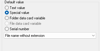

You could use the Default value to write a file name without the extension to an edit box, but...
  • It doesn't update if the file name changes.  You can (should?) limit file name changes for most (all?) users anyway, but for files in a WIP state before they're approved/released it's often nice to be able to change the name of a file.
  • While it works perfectly on files created by dragging from outside the vault (or files saved into the vault via save/save-as, or files made from a PDM template), when I use this property on a file created from RMB > New > Microsoft Excel Document, the property is written as "New Microsoft Excel Document" (and likewise for Word, PowerPoint, etc.  files) even when I change the name before doing an initial check-in.
