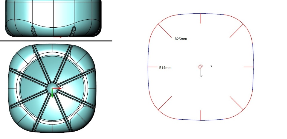

I am trying to build a variable fillet around the base of a part. The part is simply a extruded rectangle (rounded) with equal fillets in each corner. I need to have a variable fillet that smoothly transitions from two radii (radiuses). The radii need to be specified at the mid-point of each edge.
The problem that I have is that I only want to specify a radius at 8 different points (4 for each radius size) and let the rest be the result of a tangent smooth transition, however when using the variable radius feature I must specify a radius at every vertex. This causes a problem as I do not know the radius at these vertices- I have calculated an approximate but the transitions are not fluid. I would like Solidworks to simply fill in the blanks and create a smooth consistent transition. I have sucessfully done this many times in another program (ZW 3D) and the results are quick and perfect. I have also tried this in Inventor LT - although it allows me to do what I want the results are inconsistent. Any idea how I would do this?
This is a picture of what I need (from ZW3D): Base Dimensions are approx. 140mm x 150mm with a 50mm corner fillet

One trick is to only make 1\4 of the part and do the vari fillet, them mirror twice, then add other detaling features

Thats definitely a closer match, but it's still a comprimise over the original. Ideally the split line/edge would be free flowing and not become flat. This also means that the entire corner is the same radius.
Hmm I still can't seem to find a way to do this without manually working with surfaces, any ideas?

surfaces is the only way I know of because of where you would need to split the top and sides to get the flow you need.
here is my try with surfaces.
also just remembered face fillet with holdlines!!!
one more

Thanks, those are perfect results. I figured it would have to be done with a surface loft and series of steps. Wish it could be done inside of the variable fillet tool. I think an overhall of that tool would be nice.
Going to have to give it a shot with your method, thanks.
