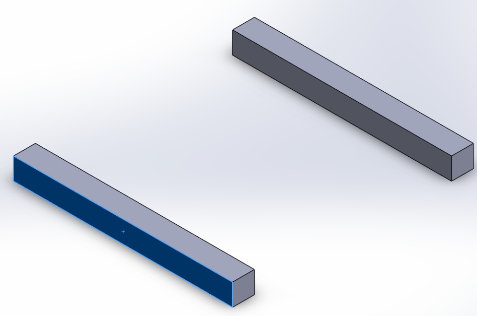

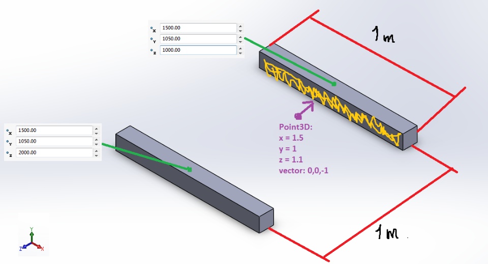

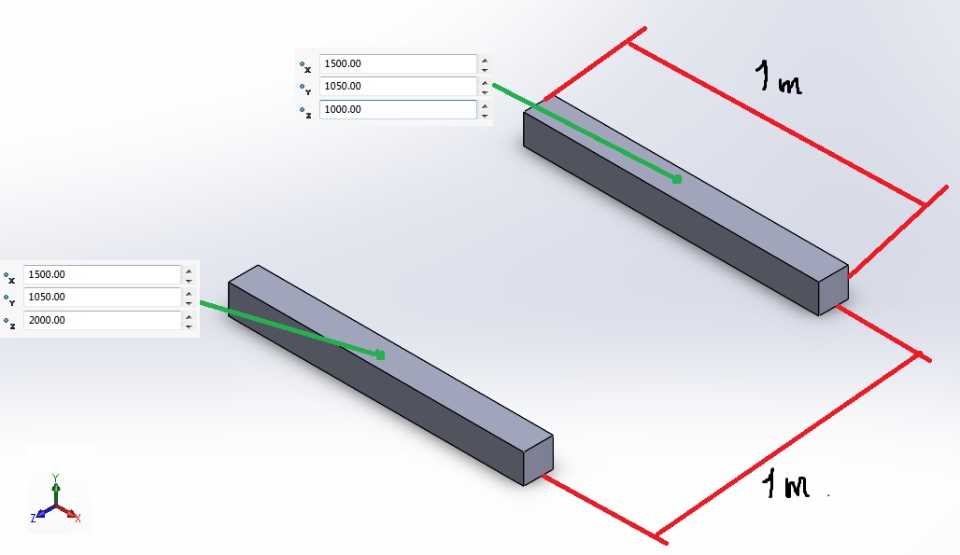

Now, I have 2 squareness, I added 2 points3D (green points) to show location.
Now, Im trying to choose orange face.
With this code:
model.ClearSelection2(True)
startPointX = 1.5
startPointY = 1
startPointZ = 1.1
rayVecX = 0
rayVecY = 0
rayVecZ = -1
radius = 0.01
status = model.Extension.SelectByRay(startPointX, startPointY, startPointZ, rayVecX, rayVecY, rayVecZ, radius, 2, False, 1, 0)
Result:

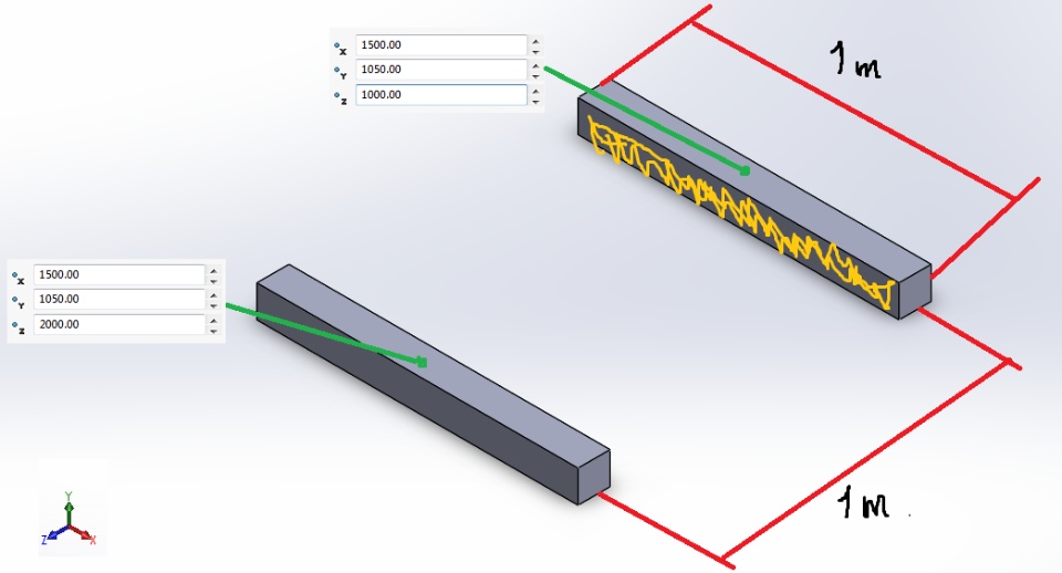

In my opinion Im trying to make something like this:
I choose point and vector which is close face and direct to orange face.
Could somebody explained me how it work? And how choose this face if I got co-ordinates of her. Before this method I used SelectByID2, but Its sometimes select wrong faces.
