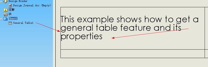

How to use WidthFactor in TableAnnotation
Sub replSwAnn()
  Dim rr, Str
  Dim SwDraw As DrawingDoc, swDrawExt As SldWorks.ModelDocExtension
  Dim SwSelMgr As SldWorks.SelectionMgr  ''
  Dim swTable As SldWorks.TableAnnotation
  Dim SwAnn As Annotation
  Dim SwTextFormat As TextFormat
  Set SwDraw = Application.SldWorks.ActiveDoc
  Set swDrawExt = SwDraw.Extension
  Set SwSelMgr = SwDraw.SelectionManager
  ' Select general table feature in FeatureManager design tree
  Set swTable = SwSelMgr.GetSelectedObject6(1, 0)
  With swTable
     Set SwAnn = .GetAnnotation
  End With
  Set SwTextFormat = SwAnn.GetTextFormat(0)'' SwTextFormat Result is Nothing
  With SwTextFormat
     .WidthFactor = 0.9 '→ don't run WidthFactor
  End With
End Sub
SolidworksApi macros
Answers 1
YN
YN 2014-01-03 Best Answer
Select Note result is True
Sub tSwAnn()
  Dim rr, Str
  Dim SwNote As Note
  Set SwNote = SwSelMgr.GetSelectedObject6(1, 0)
  Set SwAnn = SwNote.GetAnnotation
  Debug.Print SwAnn.GetTextFormatCount
  Stop
  With SwTextFormat
     .WidthFactor = 0.9
  End With
  SwAnn.SetTextFormat 0, False, SwTextFormat
End Sub
code
  Set SwTextFormat = SwAnn.GetTextFormat(0) → don't Nothing
  Debug.Print SwAnn.GetTextFormatCount → result is 1
