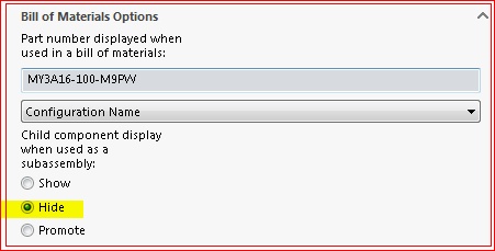

What I want is a macro to control all configuration to be set hide and show.
I have the following code, it prints out the name correctly for each configuration, but does not set the hide/show right.
Please help
