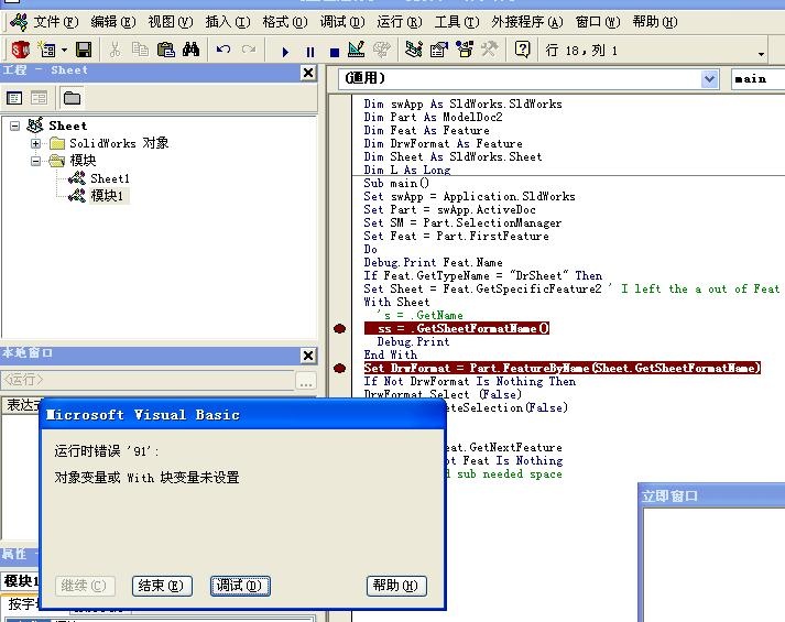

How to use FeatureByName?
Can't run this statement
Set DrwFormat = Part.FeatureByName(Sheet.GetSheetFormatName)
  the code is
Dim swApp As SldWorks.SldWorks
Dim Part As ModelDoc2
Dim Feat As Feature
Dim DrwFormat As Feature
Dim Sheet As SldWorks.Sheet
Dim L As Long
Sub main()
Set Part = swApp.ActiveDoc
Set SM = Part.SelectionManager
Set Feat = Part.FirstFeature
Do
  Debug.Print Feat.Name
  If Feat.GetTypeName = "DrSheet" Then
    Set Sheet = Feat.GetSpecificFeature2 ' I left the a out of Feat
  End If
  Set Feat = Feat.GetNextFeature
Loop While Not Feat Is Nothing
End Sub  'End sub needed space

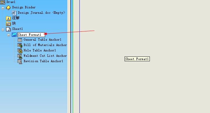

Dim SwDraw As SldWorks.DrawingDoc
Sub main()
  Set SwDraw = swApp.ActiveDoc
  Debug.Print SwDraw.GetPathName
  Dim SwSheet As SldWorks.Sheet
  Set SwSheet = SwDraw.GetCurrentSheet
  With SwSheet
    oName = .GetSheetFormatName
    .SetSheetFormatName "Sheet Format"
    Debug.Print
  End With
End Sub
