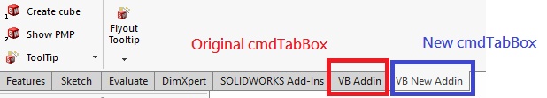

I change the Title and Tooltip in the solidworks vb template.
Then I get a new command tab box. (see Fig1)
How could I delete original command tab box in this template?
If I just want to rename the command tab box, how could I do?
