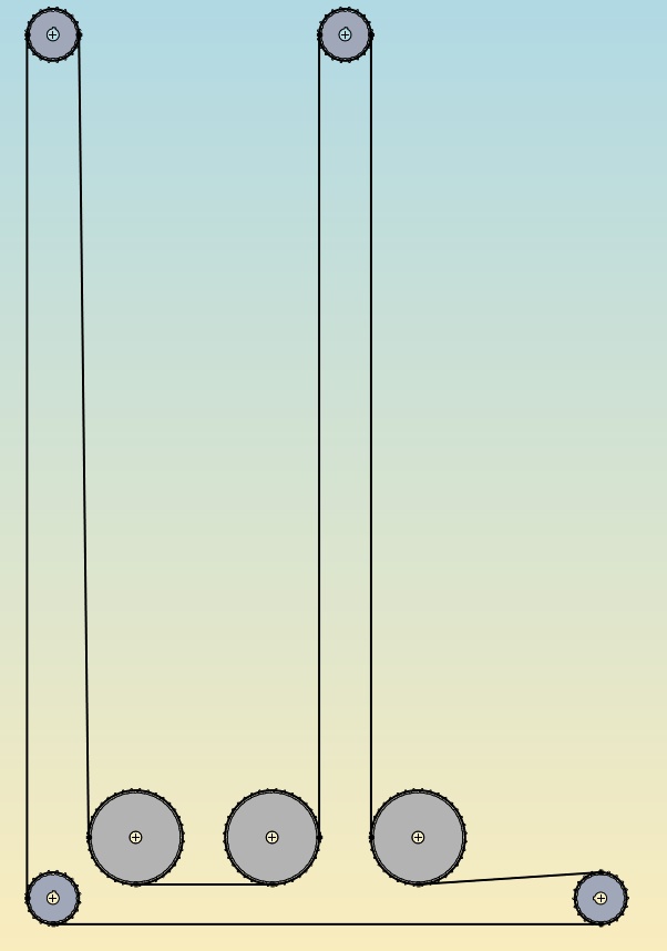

I have a sprocket assembly that I hope to have a carrier travel around.  Up to this point I have been using a single carrier for every turn and straight section.  The sketch that I am using for mating is shown below.
What I would like to do is alter the sketch so that one carrier could be mated, and travel all the way around to check for clearances.  Any ideas?

SM 2011-09-08 Best Answer
Mike,
Use the Fit Spline command.
DG
DG 2011-09-08
Fit Spline is the tool you need to use as Scott advised. And I would also suggest you to look at Belt/Chain Assembly Feature.
