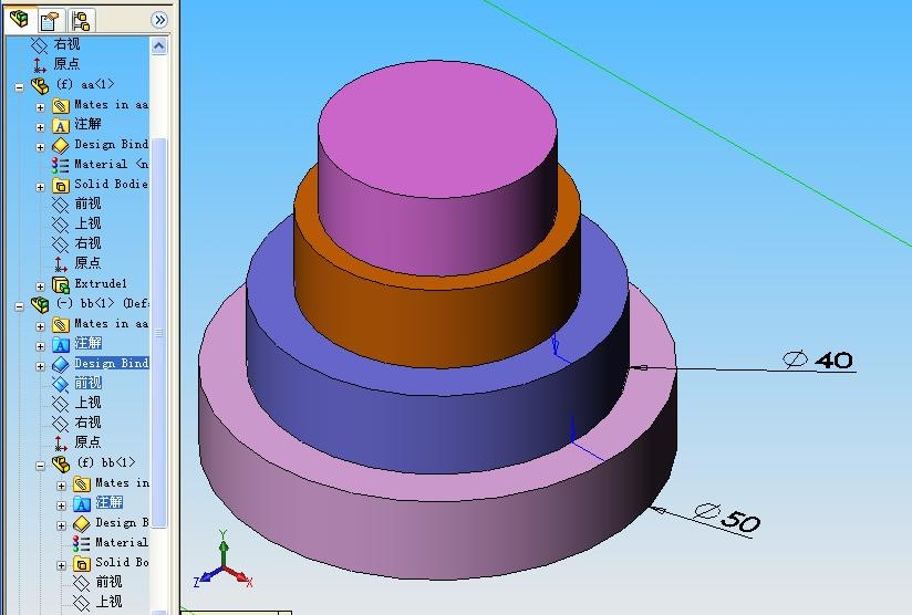

How to Traversing Assembly at Component 4 Levels ?
follow code, select  component  in Assembly.
result
File = D:\\bb\\aa.SLDASM
  Component    = bb-1/cc-1/dd-1 [D:\\bb\\dd.SLDASM]
    ParentComp = bb-1/cc-1 [D:\\cc.SLDASM]
