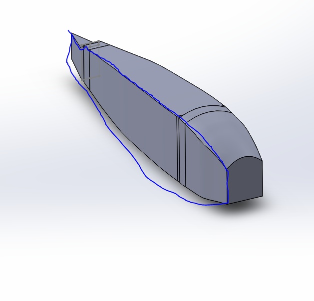

Hello, I'm using solidworks to design rc airplane, now i need a little bit bended side of solid(which is highlighted) transfer to blueprint for printing and cutting from foamboard, so I need to make that side flat and only then transfer to blueprint

Create a drawing from your part, pick that view of the side of the fuselage, scale it 1:1 and print with no scaling.  That should provide you with a template you can cut that piece from.
