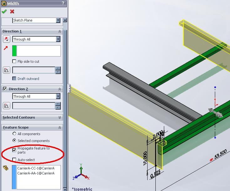

How to toggle "Propagate Feature to Parts" in Assembly Extruded Cut?
I have a assembly extruded cut feature, which I would like to toggle the "Propagate Feature to Parts" parameter with a macro.
Can anyone give some guidelines on how to do this? I've tried a couple of approaches...and I'm not getting anywhere.

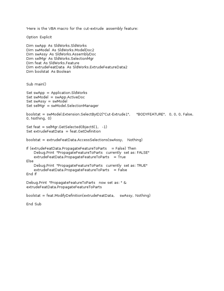

MK 2010-10-08 Best Answer
Here it is attached as VBA macro code.
FV
FV 2010-10-12
Thank you very much! Straight to the point, and very clear code!
I truly appreciate it!
cheers!
