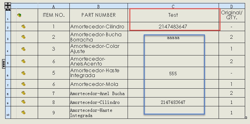

Hi all, I have one question, hope some one can help me.
For example the BOM as below, the property name "Test" I only create the in part "Amortecedor-cllindro", and I select it from the custom proerty to add to the BOM.
Then I add the content to other part on the Test property (The blue frame),  I keep the link when I double click to edit the column to add the content.
But when I open the part (Item no 2,5, 8) and check the poperty, there is no the Test item there.  So I want to know how to synchronize the cutom property content from the BOM table to the specify part.

Hi William,
When you do the process that you have described it puts it in each part as a Configuration Specific Property as shown below. Could you check and see if this is what it has done for you?

Hi Martin,
Yes, you are right, the property is there.
But do you know why those property go to Configuration Specific?
Because when I first create the property "Test" on the part "Amortecedor-cllindro", I did use "Custom".

It just defaults to Config Specific. It may be because you can have different configs shown in the same bom. ​if it did have it as just custom and there were different configs in the bom it is possible you could try to put two separate values in the custom table.
