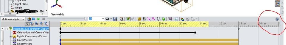

How to switch between time view and event base view study? event based study not show in my SW.
Hello,
I Want to do motion study using solidworks in event based view. But the icon use to switch between time view  and event based view not shows in my SW. how to do it?
Thank you.

SF 2014-09-02 Best Answer
what type of license do you have? event based is only in sim pro or sim prem

Hello Jared,
Thank you very much for the reply. The license is SolidWorks Premium.
