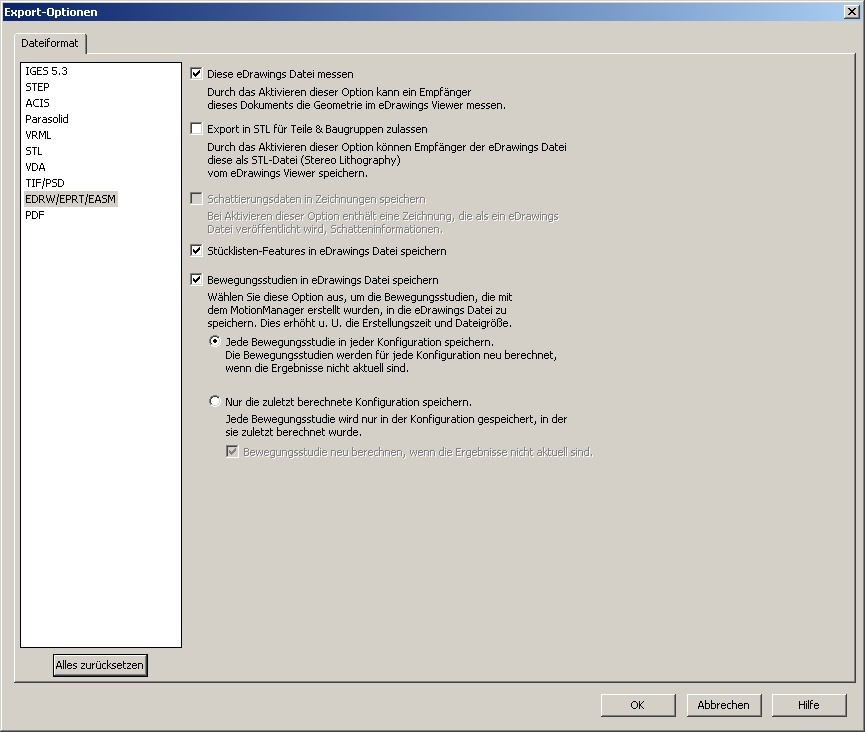

But when I save a part or assembly with mutiple configurations or a drawing with mutiple sheets while saving the eprt, easm or the edrw I always get asked which configuration or which sheet I want to save, to save only active or to save all.
Is there a way with the API to avoid that dialog and preselect that decision for example to save all configurations or sheets without asking?
I am using the newest "SaveAs" function of the ModelDocExtension, but I don't find any option in the documentation how I can do that...
