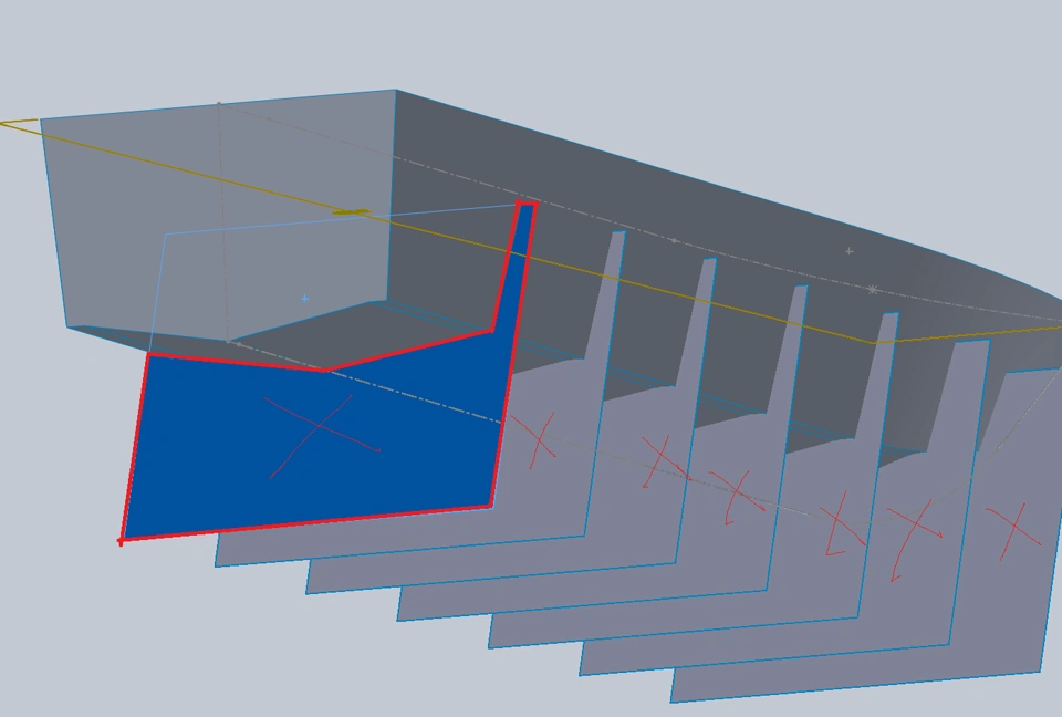

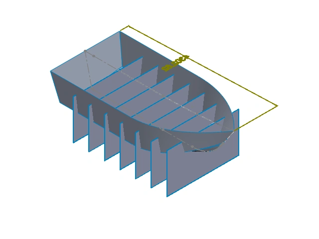

How can I split surface of a part file by another surface of a part file in an assembly?
For example, in my attached file I want to crop/trim/split the surface by hull surface.

DB2025-03-30Best Answer
As @FH mentioned., You should be able to use the trim surfaces tool to trim the outside Part2. Edit that part and select the Hull as the trimming body. When I downloaded your assembly your Part2 was found but the Hull wasn't so I recreated something similar to what you show. When you upload an assembly you should zip it so we get all the parts.

FH2025-03-30
Open your target surface part, go to Insert > Surface > Trim Surface, and pick the hull surface as your trimming tool. Make sure the surfaces actually intersect - if they don't, extend the hull surface first using Extend Surface. Check "Mutual" if you want both surfaces to trim each other, then select which sections to keep or discard. If the hull surface is in another part, bring it over with Insert > Part > External Reference first. For tricky cases where surfaces don't touch cleanly, try Split Line with the Projection option to create proper cutting edges

It looks like you can use the hull for a Cut with Surface.

try the cavity command

edit the part you want to split in the context of the assembly. copy the surfaces from the mating part. then, in the part with the newly copied surfaces, split using the surfaces.
i haven't tried so I"m notsure you can do what you want all in one step inside the assembly.
