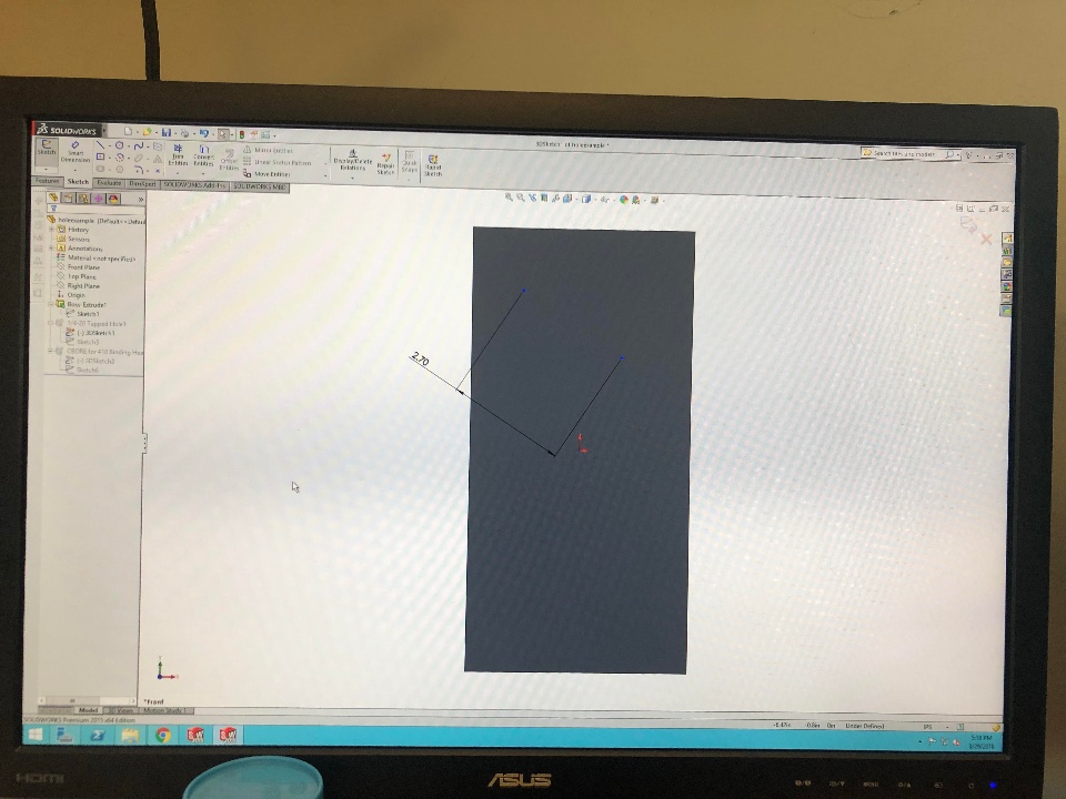

I have 2 types of holes (say the following two types):
Hole A: is a tapped hole (threaded)
Hole B: is a simple hole
How can I set the distance between Hole A and Hole B? Solidworks doesn't seem to allow that.

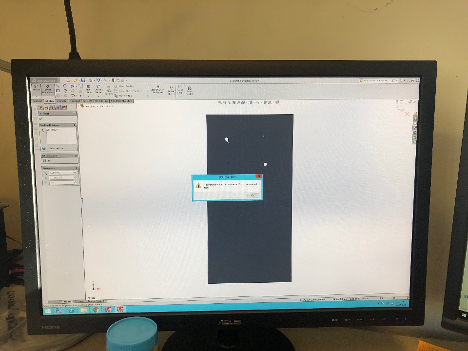

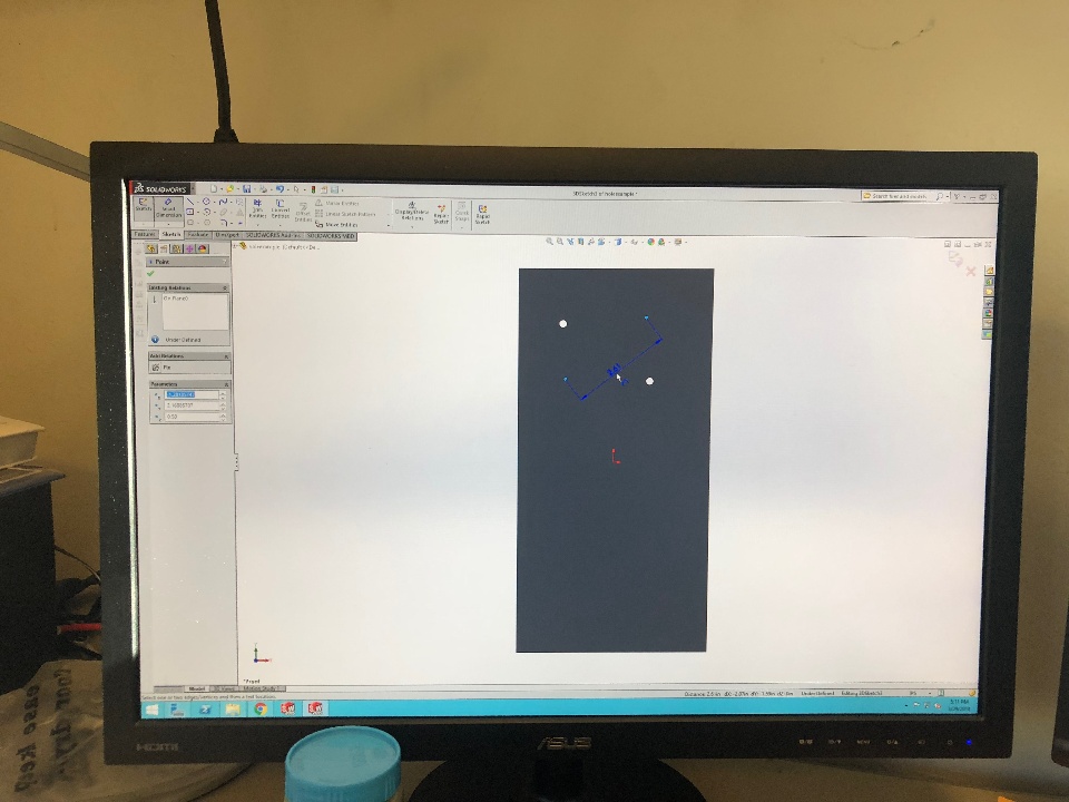

However it allows to set the distance between two holes if they are of the same type (for example: If both are of type A) (see attached image 2 and image 3).
I click on edit sketch and then click on smart dimension, On doing so, it shows the center point of the holes whose sketch is in edit mode and hence I can just set the distance between holes of same type.
Any idea on how to specify distance between holes of 'different types'?
Thank you for the help!

Hi Swati,
If you created these holes with Hole Wizard you can dimension the holes from the other type of hole just by clicking on the other types outline and then the new holes center point while you're positioning them.
If you use a sketch rather than Hole Wizard, it's done the same way.
When you're using smart dimension and click on the outline of the hole, the dimension comes from the hole center.
The hole center point doesn't have to be showing.
Hope this helps.
comment imagecomment imagecomment imagecomment image
SB
SB 2018-03-30
Thank you so much Tony. Really appreciate your detailed explanation. It worked!! I created holes using Hole Wizard.
So basically the trick is to set the location of the holes using the smart dimension while just positioning them.
