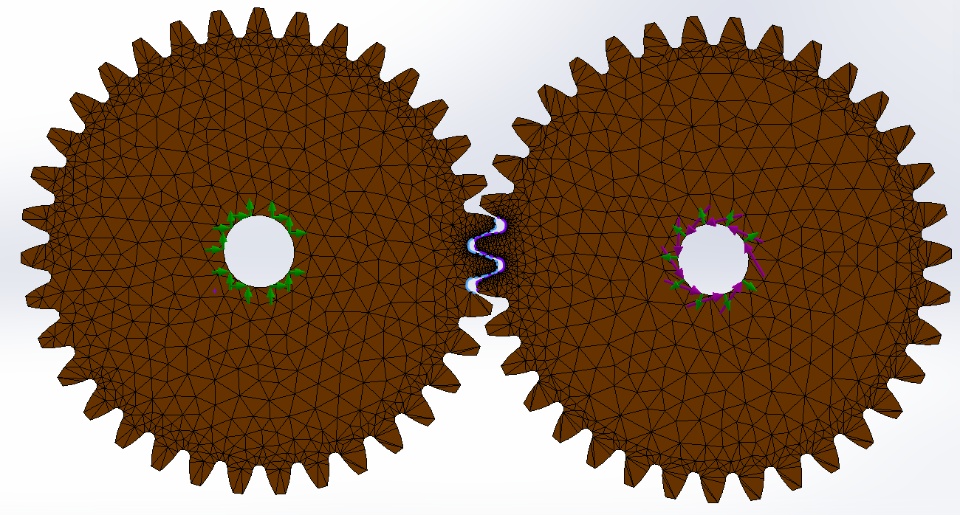

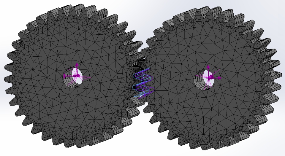

Hi,
I can't get my analysis of two spur gears working properly. I have a model of simple spur gear that I inserted into assembly as two instances and manually positioned both of them so that they can come into contact. Initially they are separated because I couldn't achieve contact between them without intersection. Remote displacements were used to constrain the hubs. One gear has only rotation around its axis free and the other has prescribed small angular displacement or torque (I tried both) in this direction. I defined no penetration contact set between meshing teeth. Of course mesh was locally refined for these teeth. Here's how the model looks like (I highlighted contact surfaces):
The analysis always switches to direct sparse solver. But the problem is that it either hangs at 27,3 % or shows incorrect results: unphysically high stress, deformation of tooth on the opposite side than the one contacting the other gear or contact stress localized in very small areas (only at the front and back of the gear).
I also tried 2D simplification but it doesn't work properly as well. I'm not sure how to constrain the model in this case since remote displacements can't be used in 2D. I also can't apply torque or prescribed rotation to the edge of the hub. This model is either underconstrained or shows incorrect deformation (for the case below the right gear expands radially for some reason). Here's how this model looks like (again with highlighted contact regions):
Do you know what mistakes I make and how I should fix this analysis so that it solves properly ?

I don't see a better solution for the boundary conditions. As I said before, "In a static study, it is best to avoid defining motion as this invalidates the assumption of small displacement.
Therefore, consider not defining any prescribed rotation to your gear. It is preferable to have one gear remain in place, and to define a torque on the other one."

Initial contact between the gears would definitely help. But how would you constrain the model in 2D ? Remote displacement option is not available in this case so boundary conditions have to be applied directly to the hubs. Which would you choose ?

I did not make any modification to the mesh or contact definitions. I changed the solver to Intel Direct Sparse.
For 2D, the only obvious improvement (but it is true also for 3D) is to set up the model so that you have initial contact (tangent mate between the teeth).

Thank you very much. Did you change something else besides the constraints/loads ? Like mesh or contact definition ? I'm asking because I get different stresses when I run the simulation from this file. And I think I've tried this approach (one gear fixed and the other one with applied torque) before but it didn't work. It seems that contact puts this analysis on the border between convergence and nonconvergence.
Also do you have an idea which boundary conditions and loads to use for the two dimensional model ?
Maybe like this?
