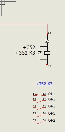

I would like to ask how to show the unused contact in the contact cross reference at the bottom of the coil symbol.
With the current symbol I have, the contact only appears (and not in the correct order), when it is used somewhere in the circuits ( refer picture). Probably there were some steps I missed during the creation of the symbol.
I'm looking for something like this:
Tq for your help. I'm still new to this Solidworks Electrical :-)

AH 2017-08-29 Best Answer
You can show unused circuits with this option under Project>Cross References>Style
I'm not sure about getting them to display in the proper order though.
comment imagecomment image

The cross reference will list out whatever you have given it.  In this case, the cross references list as RED, meaning you only attached symbols to the component K3, but did not assign a manufacturer part that has circuits matching those symbols.  Unused part contacts would list BLUE, and a used contact (symbol you've drawn that occupies the part's circuit) shows GREEN.
I'd take a step back and make sure
1)  A part is assigned to the component (go to the properties and select Manufacturer Parts/Circuits).
2)  Make sure the part has properly defined "circuits", in this case each of the contacts along with the parent coil
I missed this 2 steps :-). It solved. Thanks Andrew and Evan.
