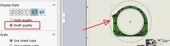

I need to show features for water-jet cutting of raw material and want to use the part drawing to do it.
I created the two dia's as construction geometry and made them visible. I created a drawing and added the view I want and it showed the construction geometry as expected. When I switched over from Draft Quality to High Quality it hid the geometry even after clicking Reset Sketch Visibility. Is there something else I need to do in order to use High Quality or will this not work with that setting?

I just tested and didn't see that same behavior.  When the sketch disappeared did you try browsing to it in the tree and right-clicking to see if "Show" is there?  If "Hide" is there instead, try selecting that, then go back and select "Show".

It shows as showing. It also shows up when I select the sketch in the tree but won't stay when I move focus somewhere else.
comment imagecomment image

I opened a different part that I worked on this morning, added the sketch and went to the drawing and it worked fine (sketch did show up when in high quality mode).
Must be something I'm doing. Will play around and see if I can find out anything. I can't send this part to the forum due to proprietary issues.

That's odd.  If all else fails, switch it back to Draft quality so the sketch will show, then reproduce all lines, arcs, circles, etc in the Drawing using the "Convert Entities" sketch tool.  Then you can hide the sketch and the lines will still be there.

I tried another part that I imported from the same assy and it worked fine as well. Not sure what is going on. I am going to move forward using Draft quality, I was just curious why this was happening. Thanks for looking.
