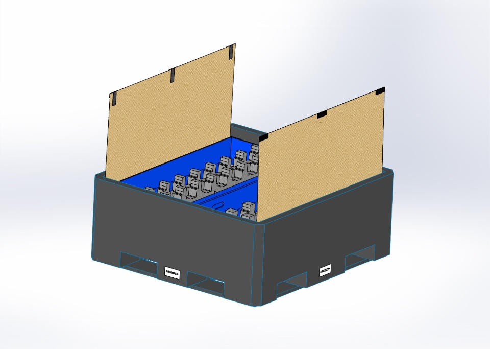

I'm using sheet metal to make a fabric box cover.  There are 2 covers per box that attached to the sides and fold over the top to meet in the middle.  So basically the cover has a 90 degree bend.
What I'm trying to do is to show one cover as open and the other as closed without having to have two separate models of the covers.  Having 2 separate models throws off my BOM.
Any ideas on how to go about this?
Thanks much!

FL 2021-04-09 Best Answer
Use Configuration.

Frederick Law wrote:
Change one part in assembly to "Straight" and the other to "Bend".
Don't need to cheat BOM.
I expect Nathan wants the covers to have the same item number and the BOM to show a quantity of 2 for that item. Jim's example shows the right way to do that, not a cheat that I can see. Or am I missing something?

After a couple of hours of a little trial and error I have a better understanding of configs. and was able to get it knocked out.
Thank you so much you guys are awesome!

Nathan,
Are you asking how to create a configuration?
If so probably the best way to show you is to suggest you try the tutorials in Solid Works. The Advanced Design tutorial walks you through creating configurations.

Sorry but how do I do this?
FL
FL 2021-04-09

As ‌  mentioned you can make two configurations of the lid. One straight and one bent. Then in the BOM select to show all configurations of the same part as one .
