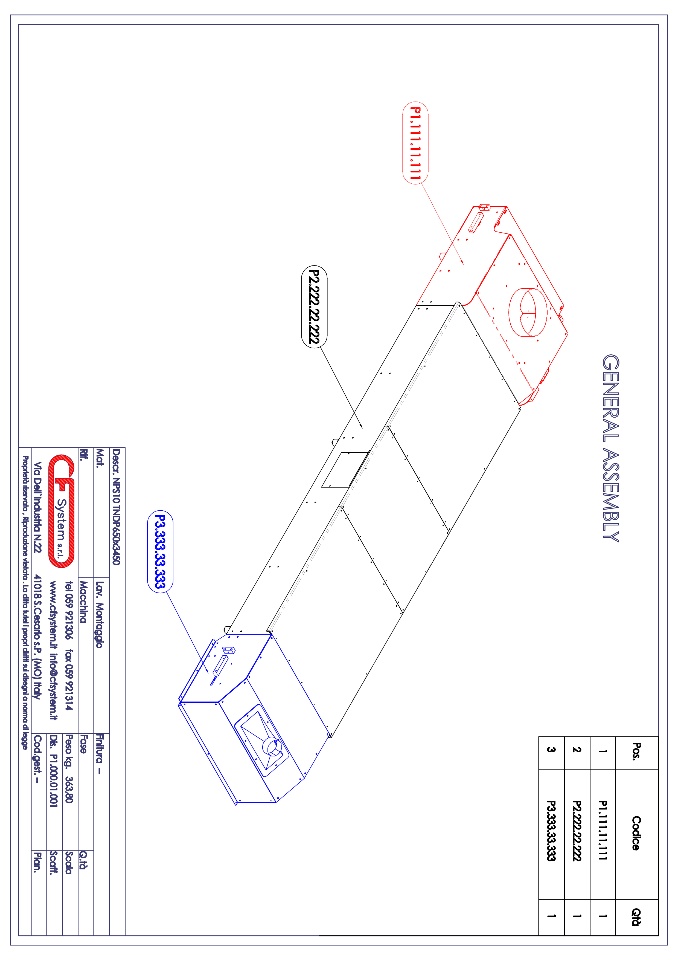

how to show correct ballooon code both in assembly drawing both in the sub-assembly, both in the sub-sub-assembly?
Hi, I honestly do not know if it is better to expose this topic in this forum (SolidWorks> Drawings and Detailing) or rather in this forum (SolidWorks> Bill of Materials), I hope that you will tell me.
In the attachment, you will find an example of what I would get.
In this example we have
GENERAL ASSEMBLY containing 3 SUB-ASSEMBLY,
Each SUB-ASSEMBLY contains various SUB-SUB-ASSEMBLY,
Each SUB-SUB-ASSEMBLY contains various SUB-SUB-SUB-ASSEMBLY,
and finally every SUB-SUB-SUB-ASSEMBLY contains various PART,
for each one of these I create a drawing and in each drawing I want to insert the balloon with the correct code for each sub-assembly or existing parts.
I had tried many ways but I did not succeed,
can you tell me if you SWX permits, and how to do it?

Actually
Hi Matthew,
yes, the attached example represent my goal,
"code" is the number of the drawing, which represents the part, assembly or sub-assembly.
Maybe I have not attached all the images, I now add them.
My goal is to be able to peen (ballooning) what is that particular designs (example: General assembly that the assembly is made up of 3 sub assemblies, so even if I point the balloon on a particular as a bearing or a bolt should NOT be possible to have the code of a bearing or a bolt but only the code of one of the 3 sub-assemblies), and for each design I want to also table (the table was missing in the example pdf) that shows ONLY the codes that I can peening (ballooning), and yet I do NOT want to see the codes of the sub-sub-assemblies or component parts.
In the first image below (the one with the table), you can also see that POS. 3,4,5 are visible (but I want to see only a single code "x" = C1.029.02.005 because in this design I added to the subassembly C1.029.02.005 and I have NOT inserted directly the pos.3,4,5)…
So in this image, the elongated balloons with the code are correct, but the table and the round balls are wrong (round ball do not interest me, i delete them, but I would like have a correct table) why the table is wrong? how can I correct it?
Instead, in the second image (the one without the table) the elongated balloons with the code and the round balls are wrong .... : (  (I did not understand why the behavior changes).
I would like to get this behavior for all the designs that represent the assembly, sub-assemblies sub-sub-assemblies, .... until the last sub-sub-…-sub-assembly.
I would like to avoid working with configurations because this would complicate very much the work.
Could you help me?

JB
JB 2013-11-15
Currently in SolidWorks there is no way to do this except to attach your balloon to some entity that exists only in the subassembly.
You can create some sketch geometry inside the subassembly file.  Then you can open the drawing, show that sketch, attach ballon, then hide sketch again.
LR
LR 2013-11-22
Hi Josh!
thank you very very much for your suggestion.
Initially I was not convinced your idea, it seemed complicated, but then I tried it and I realized that your idea is a winner!
I added a sketch (a construction circle) at the origin and sketch what I renamed as ((link assembly)), in order to connect the arrow of shot peening to the sketch you need to use the right button and choose "ripristina la visibilità dello schizzo"(restores the visibility of the sketch), after it is possible, as you suggested, hide the sketch and everything works fine.
To distinguish the balloons part from balloons assembly I use two types of different outline, in this way I can always see which balloons are referred to a single part, and which balloons are referred to a subassembly.
