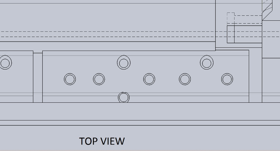

Hi Folks,
I am trying to figure out how to show a model axis in a drawing.  I need to pick up the center of a tapered hole, (a cone), from above and can't. The center mark feature doesn't work because the tapered holes break-out on non-planer surfaces on both sides of the part.  I can easily add an axis to each hole in the model but they don't show up in the drawing and thus I can't pick them.  Any suggestions?

I actualy already had that selected.  So I tried "View -> Temporary Axes" and they all showed up as blue lines and points.  I can dimension to them but I guess I need to turn them off after because there are 1000 blue lines and dots all over my drawing now.  How do I create non-temporary axis? So only the Axis-Features in the model show up?

I figured it out. View-Axes alone won't do it. I selected the view in the feature tree, then expanded it to see all the part features.  Sellect the axis I want to show in my view, R-click and select -Show.  The Axis then shows up as a tiny dot that I can sellect.  No other axes are visible.

It's funny because it was set to show in the model but in order to see it in the drawing I needed to go onto the feature tree from the drawing view and set it to show.  Apparently you can set features to show/hide in the model and the drawings separately.  It works with sketches too.  I never knew that.
