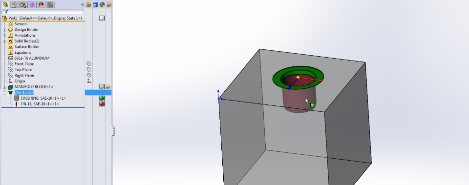

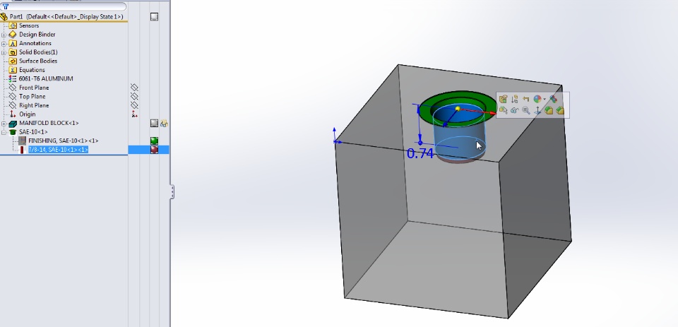

I am in need of programmatically showing the Display dimensions of a specific feature in a Part Document.
I have tried using selectbyid2, ISelectionManager.AddSelectionListObject, ISelectionManager.AddSelectionListObjects,
All of the above select the feature, but the feature dimensions do not display the same way if i select it in the Feature Tree.
The features i am trying to Select Programmatically have No Faces.
They are MacroFeatures
They have Display Dimensions
See the attached screenshots.
The Code to do this is:

All this Sub Does is gets the Selected feature by either SwSelecttype_e.SwSelBodyFeatures or SwSelType_e.SwSelFaces.
then it gets the Owner Feature which is the Feature i want to Show the DisplayDimensions of.
i have tried getting all of the IDisplayDimensions using IFeature.GetFirstDisplayDimension and getting the Annotation from The IDisplayDimension using IDisplayDimension.GetAnnotation
Then Setting the IAnnotation.Visibility to SwAnnotationVisibility_e.swAnnotationVisible which does nothing.
I can make an IAnnotationView and show that but i dont like doing that because it would involve making a new one every time. you cannot name them so getting a special annotationview and clearing the IAnnotations from it seems like too much work. if i have to, i will though.
But i would like to see if there is an easier route.
Thanks
So Basically all i want to do is show the displayDimensions of a feature without having to select anything.
So Like IFeature.ShowDimensions would be sweet, or something to Achieve this goal
