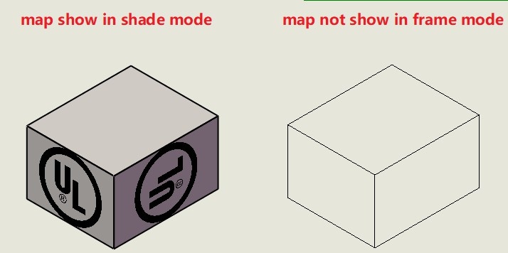

I have a model with a symbol or map on it, i want to show the symbol or map in drawing frame mode.
But the map can't show in frame mode like the picture below.
  • Is there any other method that i can show the symbol or map in symbol or map?
  •   ---It is better that the "front surface" and "behind surface" will not perspective.

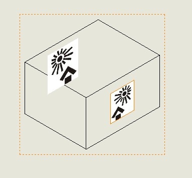

  • I add a sketch picture into a surface sketch, and set the sketch visible in drawing, the problem is the "front surface" and "behind surface" is perspective, it is not the effect i want.

What has been suggested here are correct. You can put each picture in a separate sketch and choose to show any of those sketches you need for each drawing view.
Instead you can do something a bit more interesting. That would be creating a sketch by mimicking the shape of your logo or picture. Then, you can use that profile to create a boss extrude or cut extrude with a tiny depth. Then, that will be attached to your model and will work as other edges of the model works. No need to hide or show sketches, etc. For example for the pictures you are showing, this can be done very quickly, by drawing circles and drawing some lines and arcs to shape U and L, etc. You can even add colors to faces to show with real colors in drawing when you choose to show Shaded.

Make sure you put those pictures in separate sketches and then you can show/hide the required sketches.

Thank you, if i have two sketch pictures in frame mode, i can't only show the front one, it will show all two sketch pictures.
  • I need to show only the front sketch pictures in frame mode if i have two or more sketch pictures in model.
