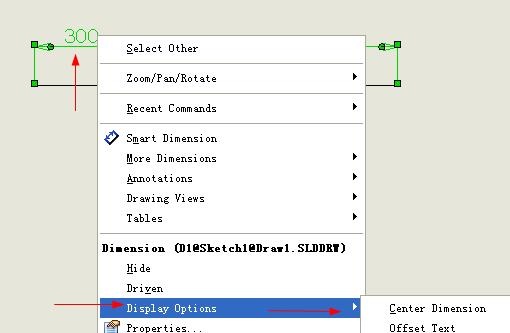

How to set center Dimension in drawingdoc with API?
Set SwDim = SwSelMgr.GetSelectedObject2(1)→ SwDim as Dimension → don't set center dimension.
