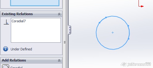

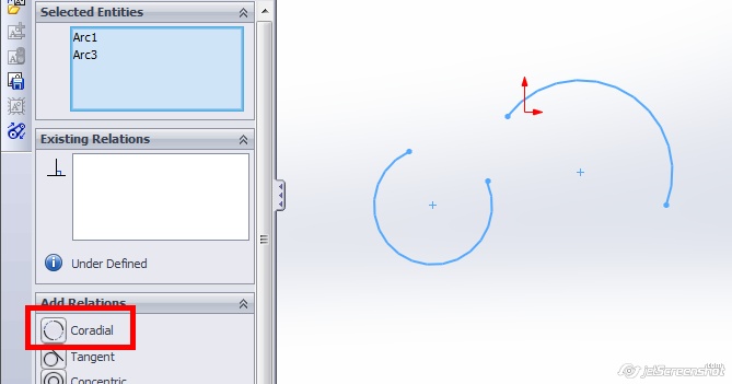

If I have two arcs, and select coradial there is two solution:
This:

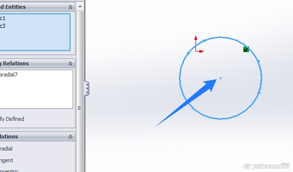

And this:
I have get the second solution fixing the bigger arc, but my question is if there is a more intelligent and faster solution to decide whichone moves, cut or whatever.

There doesn't appear to be any order to this, no matter which is drawn first or selected first.
GS
GS 2015-03-26
If you have a preference as to which one stays in place, then fully define it's centerpoint first, such as by making it coincident with the Origin, before applying the relation.
JS
JS 2015-03-26
Or if you don't want to fully define it yet you could add a fix relation to one before adding the relation, then delete the fix relation afterward.
PJ
PJ 2015-03-26
In fact, I made thisway in the last picture. My question was for " the cleaver solution"... if it exist.
