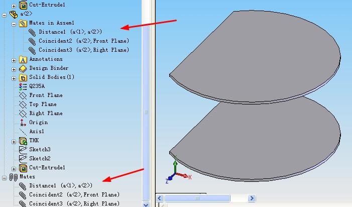

How to select Mate feature in feature tree with traverse method.
Follow code,  traverse feature tree , how to  select   mate feature →Distance1(a<1>,a<2>)
e.g.
boolstatus = Part.Extension.SelectByID2("Distance1", "MATE", 0, 0, 0, False, 0, Nothing, 0)
Private Sub mMate()
   Dim SwApp As SldWorks.SldWorks, SwModel As ModelDoc2
       Set SwApp = Application.SldWorks
       Set SwModel = SwApp.ActiveDoc
   Dim SwFeat As Feature, SwSubFeat As Feature
       Set SwFeat = SwModel.FirstFeature
       Do While Not SwFeat Is Nothing
          'Debug.Print SwFeat.Name, SwFeat.GetTypeName
          Set SwSubFeat = SwFeat.GetFirstSubFeature
          If SwFeat.GetTypeName = "MateGroup" Then
          End If
          Do While Not SwSubFeat Is Nothing
              Debug.Print SwSubFeat.Name, SwSubFeat.GetTypeName
              If SwSubFeat.GetTypeName = "Mate" Then
              End If
              Set SwSubFeat = SwSubFeat.GetNextFeature
          Loop
          Set SwFeat = SwFeat.GetNextFeature
       Loop
End Sub
