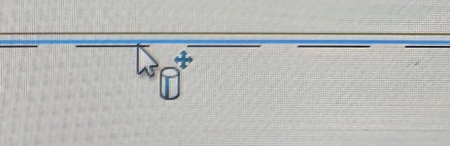

Can Anyone suggest me how to select this edge in drawing sheet for adding dimension with C# ?

object[] axes = (object[])swView.GetVisibleEntities2(null,(int)swViewEntityType_e.swViewEntityType_SilhouetteEdge); I am getting null here . It is sheet metal part
